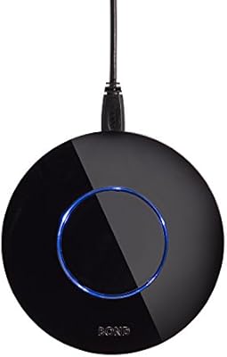

If you don't want to wire anything, I use the Bond controller that learns fan remote RF commands from multiple fans as well as fireplace remotes.
or
The device doesn't need to be in the same room and has pretty good range. There is a user driver and app that integrates these into HE.
Allows me to turn on/off/adjust fan speed/light level easily. Doesn't require any rewiring. If you choose to go the Zwave switch route, you'll need to remove the fan's current RF module (usually located in fan canopy)

This device will learn my current remote control's RF signal then allow me to issue commands from Hubitat?
What if I wanted to add buttons to control these commands? What would you recommend?
Yes, that's how it works. Once configured, they appear as devices, so I'd say that any button controller ZigBee, Z-Wave, Lutron should work. I use Picos around the house to control non-Lutron lights which works perfectly. I don't use them for fan control though -- I prefer voice.

So I got the BOND thing.
Trained my fan's remote.
Works great from the BOND app.
I added the code for the app and the driver, but I cannot get any devices to show up or work when I add them manually.
I did configure the app.
Gave it the IP address and also the token. I set the IP address to static and can confirm that when I move to next step the HUBITAT app can see the two devices I've configured.
Any idea which way to go to get them to be controlled from within Hubitat?
FYI I got it after checking the logs.
I had to add the correct drivers for the devices I have in BOND.
In my case I needed a FAN with DIRECTION and FAN LIGHT.
The logs hinted at not being able to created a certain devices so I tried other drivers. I did not add all because I did not want to add any more than I needed.

OK got this one solved too.
  1. I made a virtual switch.
  2. I made a rule triggered by the virtual switch that checks the existing status of the light and if it isn't already in the state it is in, then it sets it to the state I want, otherwise it does nothing.
    It uses an IF and then an END IF conditional statement in the rule.
The magic is being allowed to check the current state before taking action (or inaction).
So far it works as long as I do not use the BOND app to change states which will get them out of sync. This works for me since I did not plan to use the BOND app and want to delegate everything to HUBITAT.
I was inspired by this Wink Relay solution, except mine seems a lot less complicated (probably since it doesn't have to account for Wink Relay loads logic:
In the end, there is a noticeable delay between button push and fan taking action, but that is not the logic of the virtual button, that is Hubitat-->BOND-->RF-->Fan communication. There was always a noticeable delay between fan and its original RF remote. I just have to live with it if I keep RF in the mix.
In the end this solution works great without having to disassemble fans and rewire them.
The only issue is that the remote has the same effect as using BOND app. Since my wife and daughter like the remote option, I will replace that remote with another Hubitat supported Z-wave remote.

I have a TV lift cabinet I built and I had to use a separate remote for that.
Guess who learned my TV lift RF signal and is now recognized as shades in BOND?
It's almost too perfect since shades go up and down, just like my TV lift.
I just killed RF 6 fans and an RF TV lift with this one device.
If I could mount it within line of sight of my TVs it would learn those IR signals too.
