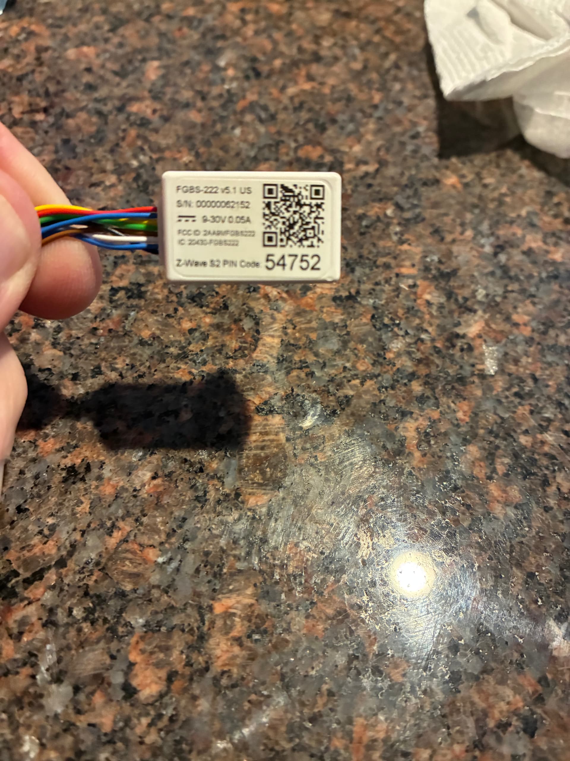

@elipitbull
You can have mine for postage.
