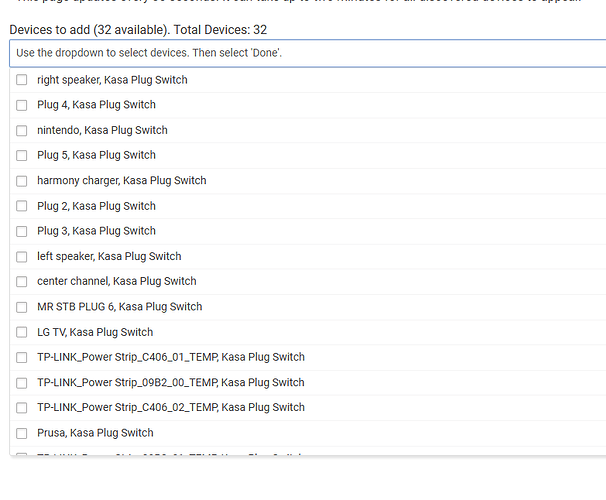

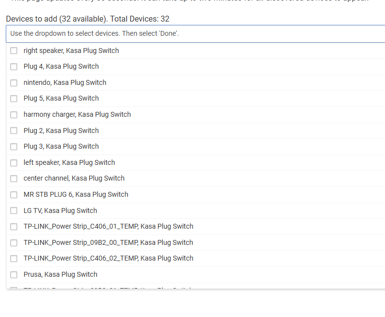

I'm running into an issue with a new hubitat where the hs300 wont show up individually.. how do i fix? Shows up as TP-Link Power strip etc as seen in the pic
The Kasa integration provides a device for each plug (6 total) but does not install the top-level device.
