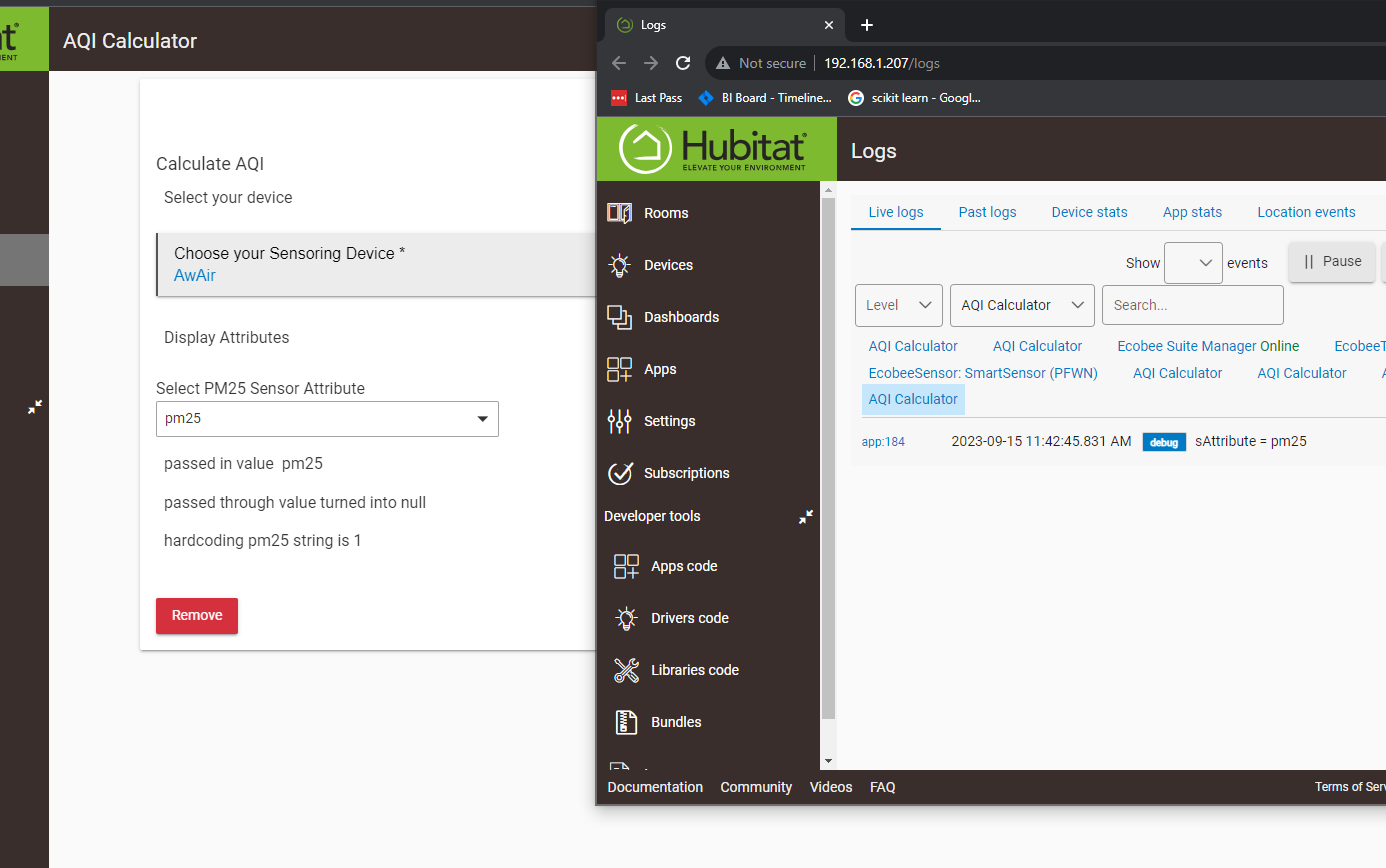

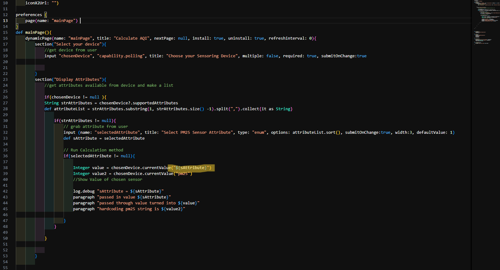

Thank you. I included a cope snip and my app output.
I did change my variable naming convention and added a log output to validate. i had been using paragraphs to spit out values on the screen while i was running the app.
Here is a code output
and here is the app output with log output. sAttribute displays properly in the log but when passed into currentValue it passes null. If i take what the value of sAttribute is and hardcode and pass to currentValue i get the sensor reading. I am sure this is a property syntax thing I am not understanding with groovy.
A screenshot probably isn't the best way to share code, but I guess it shows more context than a line or two. :joy:

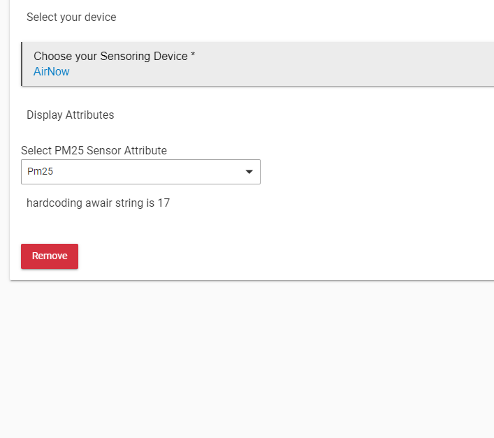

So i put a switch statement in for now that will give me the value. Two issues for some reason the value coming out of the attribute field on both drivers has a space prefixing the value so instead of "pm25" its needing " pm25" to enter the case statement. I still do not understand why the .currentValue() method is forcing a literal string passed and i cant pull that from a variable. In other languages i would use variable.ToSTring() to force or getvalue(variable) but you cant use a method call inside of the currentValue method so idk for now.
