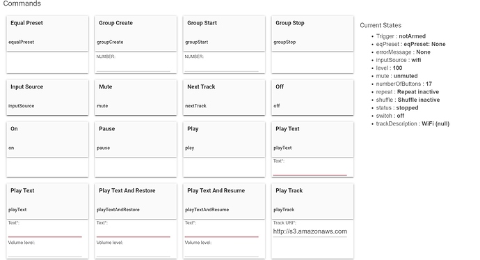

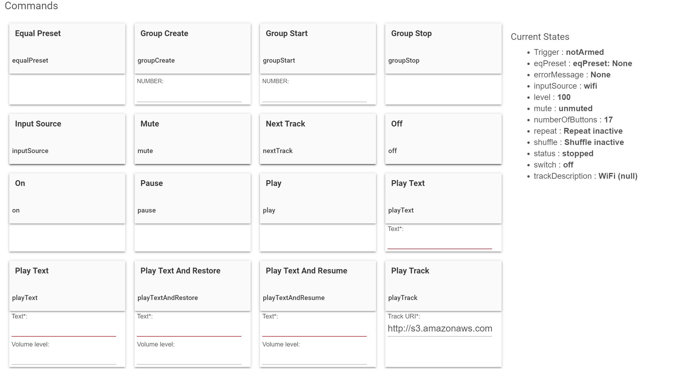

Honestly, I have no mp3's of my own anymore if that's what your asking. I've tried different links from the web that do play in Chrome browser though. I am on the 03.01 version of the driver. Could that be a part of the problem I'm having? I don't know how to update it without just deleting it and reinstalling it.
This is what I see after I put in the bell mp3 and click play track.
Give me until tomorrow to update and validate functions. Above, you should have heard a bell. My favorite is barking dogs.
