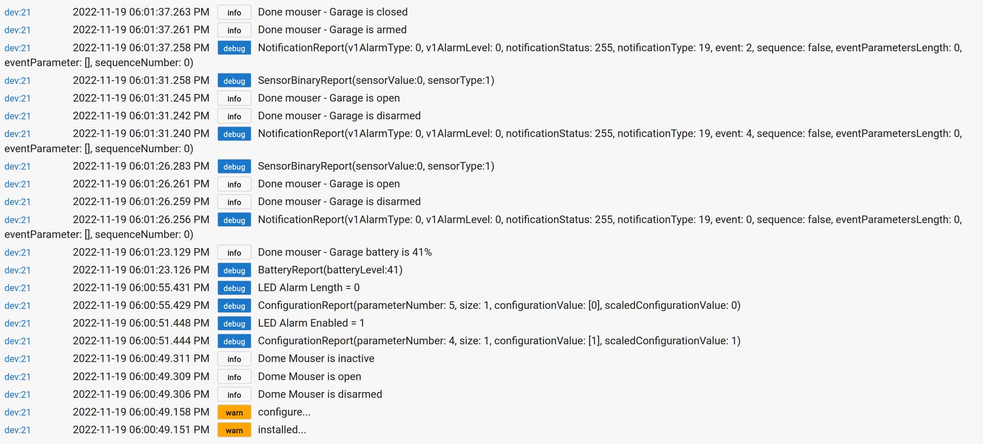

The type is correctly detected as Dome Mouser.
Sorry, the previous capture was done while it was still a Dome Mouser device. I switched it to Device and this is what I got.
Ok Notification type 19 (0x13 in hex) is Pest Control, and event 2 and 4 is related to arming/disarming. There would be an event 8 for "Pest Exterminated", and it should also send a Notification Type 7, Event 8 at the same time which is the Motion Detected alert (also being used by this device for Pest Exterminated probably for compatibility with older hubs that don't recognize type 19).
So, thus far in those log the device has not sent an alert to indicate it has caught something.

When a mouse (or in my case a humid paper towel) gets into the mouser a red LED lights up but no zapping yet. After 3 seconds a very long zap starts, it sure felt like a whole minute, but it may have been less. Then it starts pulse zapping the critter for another period of time and only when this is done the LED starts blinking that there is a kill and notifies the hub with notificationType: 19, event: 8.
I assumed that the notification is sent out when the zapping starts so I turned the mouser off so it never got a chance to send the notification. You know what they say about assuming...
