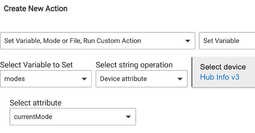

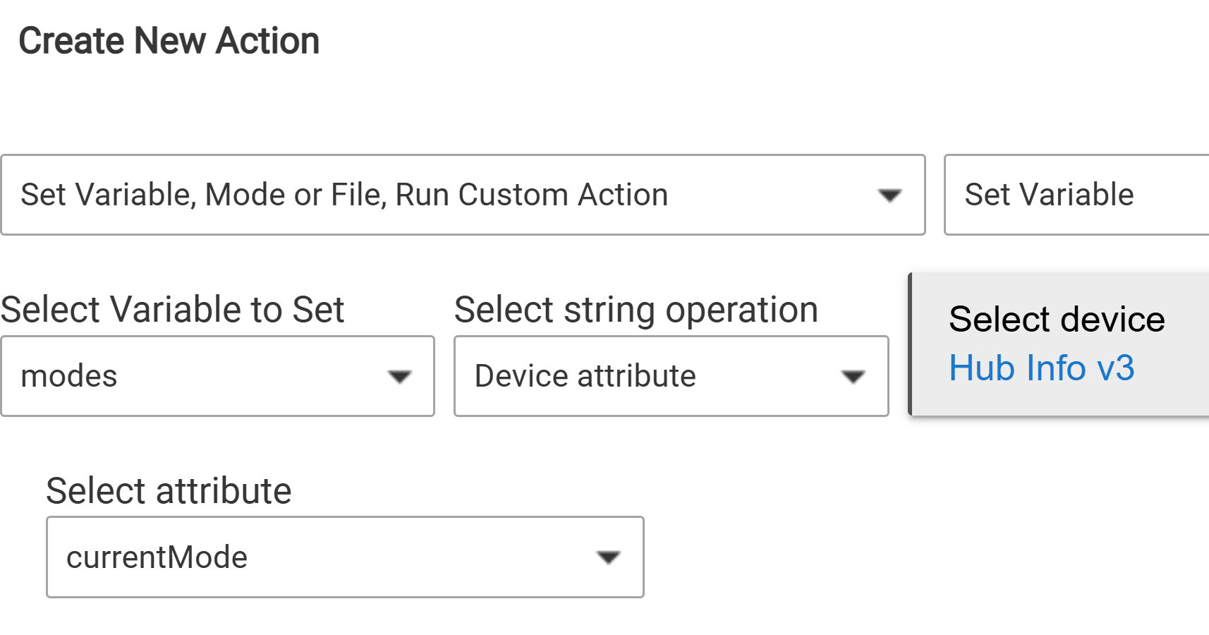

I think it's easier to get current Mode using Hub Info v3 driver (by @thebearmay )
In rule machine, you could do this

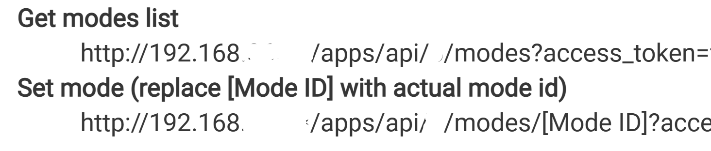

Just noticed this after a recent update, and wonder if you've experimented with either Maker API method?
