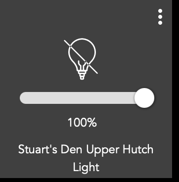

How to get a non-dimming bulb tile to not have a dimming slider on a classic dashboard?
On a classic dashboard I have light fixture that plugs into a smart plug. I picked the bulb template for my tile.
Why does it have a slider as if it were a dimmer and not just a bulb (since there is a separate "dimmer" template)? Naturally, sliding the dimmer bar does nothing.
How do I get the icon to be just a bulb without the dimmer slider?
Screenshot 2025-06-03 at 10.08.33 AM

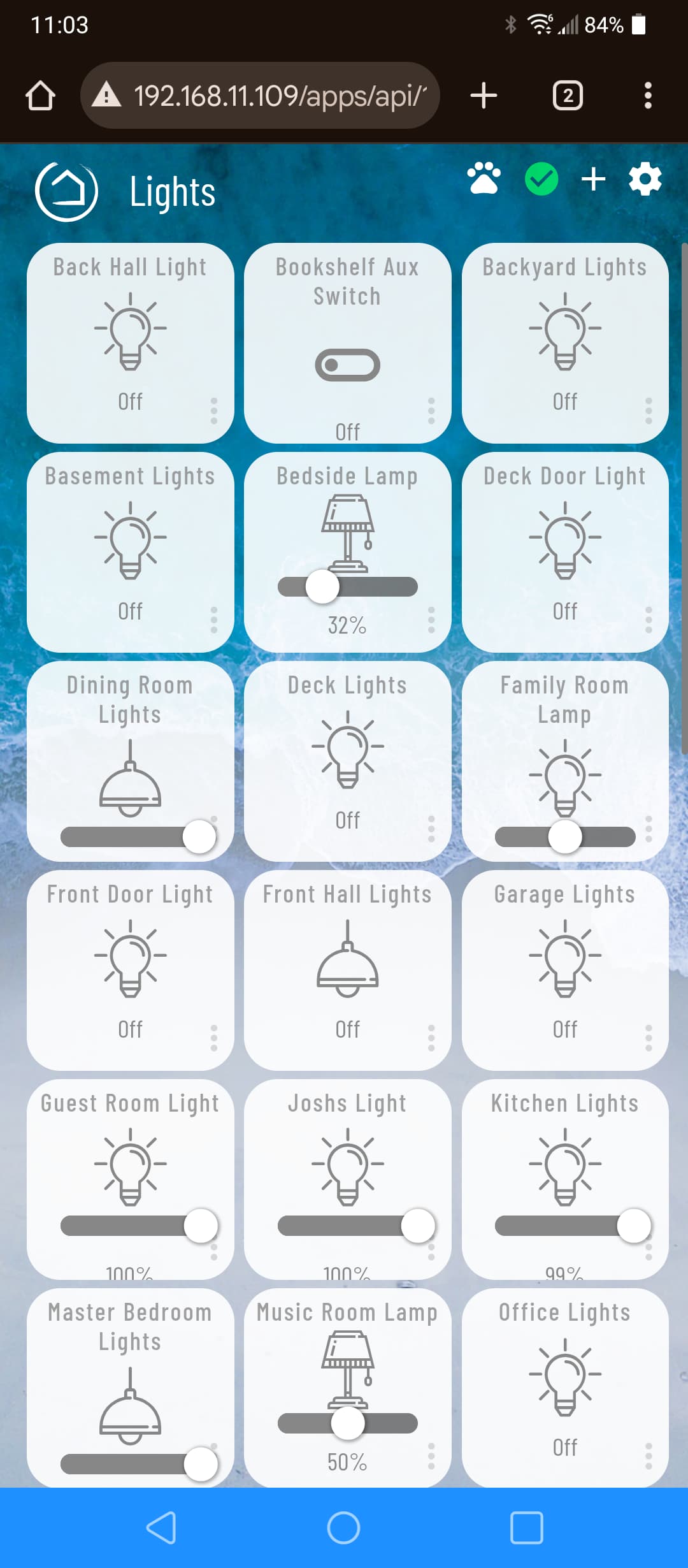

For me, personally, I've long stopped looking at the icons. The tiles are in positions they've been in for 6-7 years now and I should be relying on muscle memory... BUT.. it happens I don't use Dashboards much, despite hours spent keeping them accurate. I still have to read each tile to find the one I'm looking for. The Icon doesn't help as much as I once thought it would.
I've noticed though, that "a switch with a dumb bulb attached" is a popular item in my home and my mind still thinks of it as a light, not switch. So the NEED for a tile that matches probably existed since inception, and hasn't vanished over time.
Where did you get those icons from?

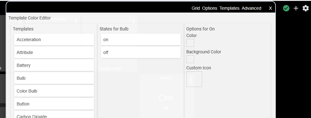

It does, unless you choose the same icon for both states. The template editor I referred to above lets you pick a different icon for on or off, which is ultimately all the switch toggle itself (think of it as the default icon) is doing, too.
Can you please point me to where can I get that template editor

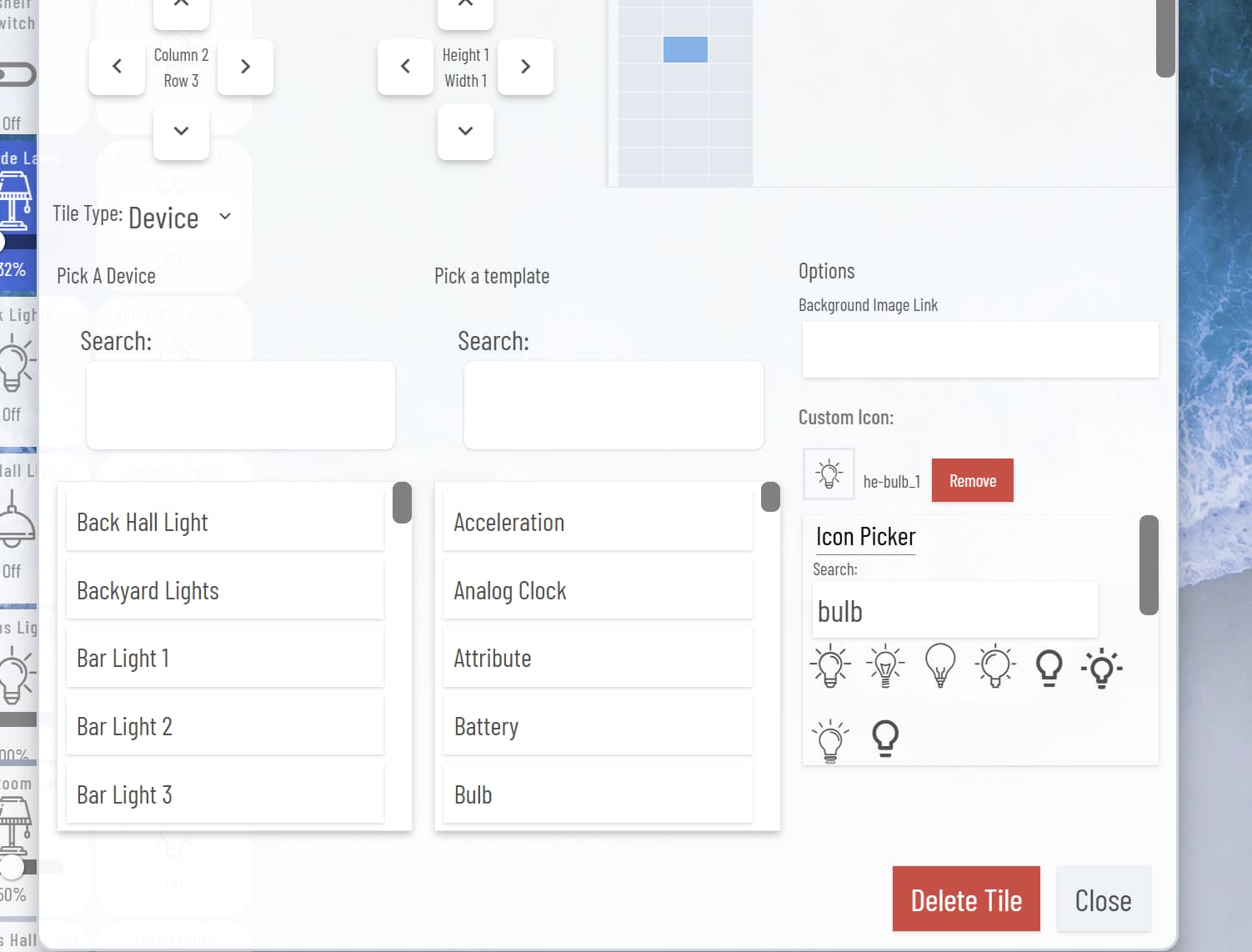

not true see pictures this is built in functionality in legacy dashboard and lets you pick the icon.. and it would only apply to that one device/tile
as for the template background etc. i was using smartly..
if you want the same template i can post my templates and advanced tabs from one of my dashboards and then you could paste them into one of yours then modify and add your own devices.
Select the gear icon in the upper right, then select Templates:
To do what I described above, you'd then want to find Bulb in the templates list, along with whichever state(s) you want to customize:
My statement is correct for the template editor, which is what I was referring to, and I would appreciate it in future posts if you could stop habitually referring to posts written by others as "wrong" or "not true" when the only problem is a lack of contextual understanding, as this is likely to be confusing for others reading at a glance.
You are correct that you can also set an icon for the tile itself (but without further work, it won't change based on states like the template icons can). This is just a different thing.

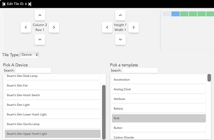

Should be super simple. Try this (it worked with the "bulb" template):
While editing the dashboard, click the settings icon (upper right corner).
Click Advanced, then on "CSS"
Add this line to the edit window:
#tile-123 .dimmer{display: none;}
Then click save and the "x" in the upper right to close the window.
Where "123" is the number of the tile with the dimmer you want to get rid of.
To find the tile number, click on the the 3 dots on the right side of the tile and look in the title bar for the number.
