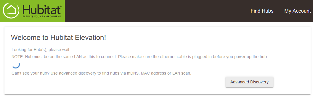

I tried http://findmyhub.hubitat.com on basic mode it couldn't find the Hubitat.

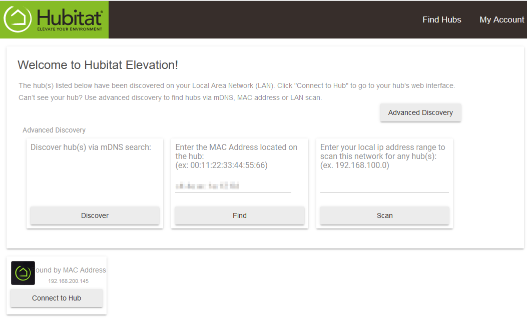

On Advanced Discovery using MAC address was able to find the Hubitat, same IP as before.
However when I click on Connect to Hub it still shows "Problem loading page, Unable to connect" message
