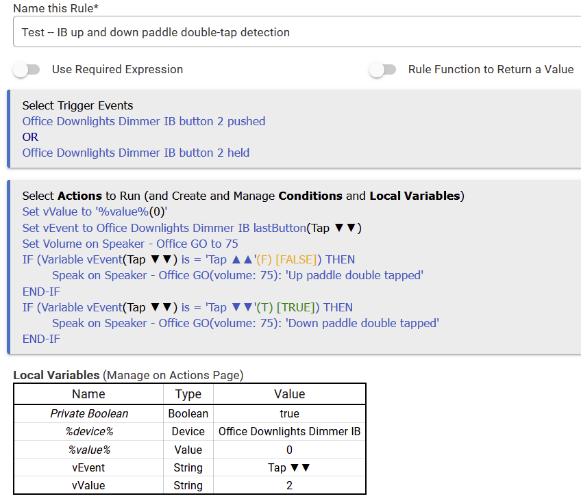

Instead, the “lastButton” attribute can be used to determine the number of taps. That attribute returns strings like “Tap ▼▼” (down paddle double tap) and “Tap ▲▲▲” (up paddle triple tap). Example test code:
Note that you may still need to test %value% for being equal to “on” or “off” for cases in which a dimmer is turned on/off by another rule.

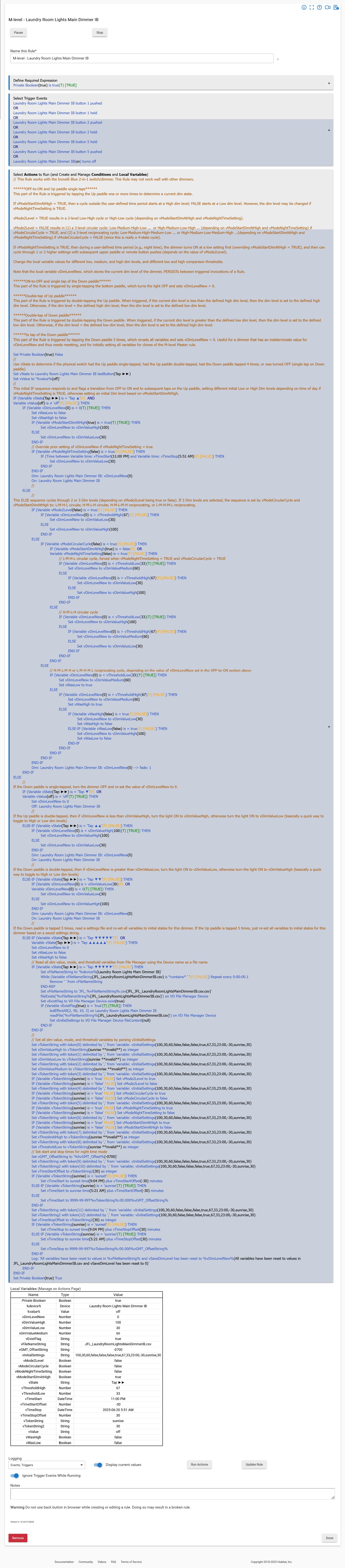

Understood, but my actual rule (of which I have 30 instances) requires knowledge of previous states when a switch paddle is pressed. Rather than use hub variables and MANY more rules per light switch (which was my ver. 1.0 approach), for sake of my sanity in keeping track of (and replicating) rules, I put everything for each dimmer unit into one associated rule, hence the need to distinguish UP taps from BOTTOM taps (which is NOT straightforward with Inovelli Blue dimmers). Button Controller also doesn't quite work without passing a bunch of hub variables around to track state.
Here's an example of my rule (which is "self programming" in the sense that ALL internal rule variables can be set by the rule itself reading a File Manager CSV file; all such files are written by a single master rule that sets the parameter values):
