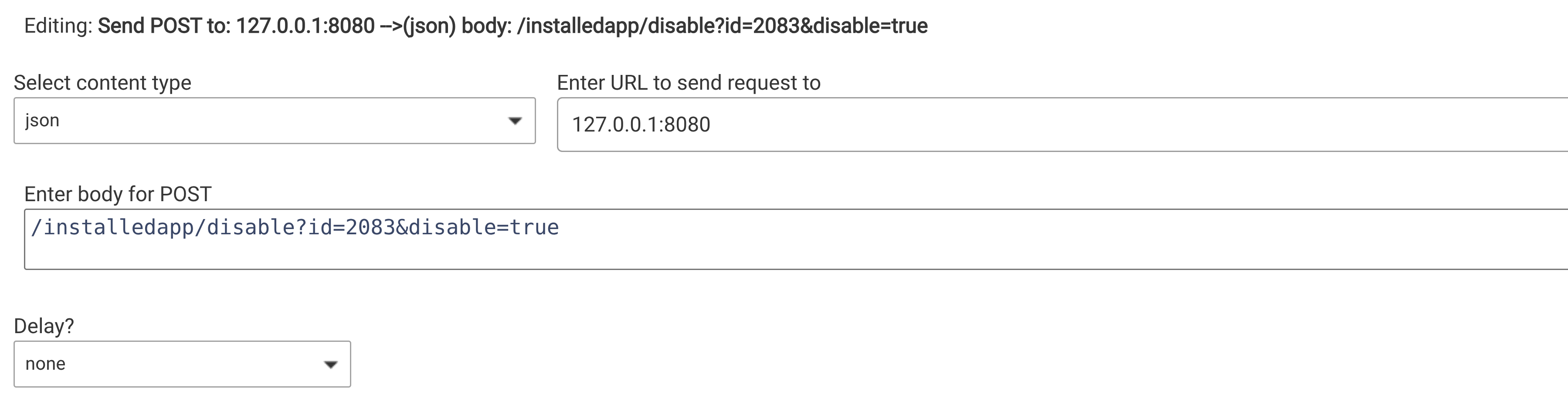

I'm using this call (http://hubIPaddress:8080/installedapp/disable?id=MakerID&disable=true)
As @JimB indicated, your actions in Rule Machine should be as follows:
To disable:
Send POST to http://127.0.0.1:8080/installedapp/disable?id=2083&disable=true
To enable:
Send POST to http://127.0.0.1:8080/installedapp/disable?id=2083&disable=false
Note that an HTTP POST action is being sent.
I'm somewhat confused.
Isn't that exactly what I had put in?
No, there is no body; it should all be part of the URL.

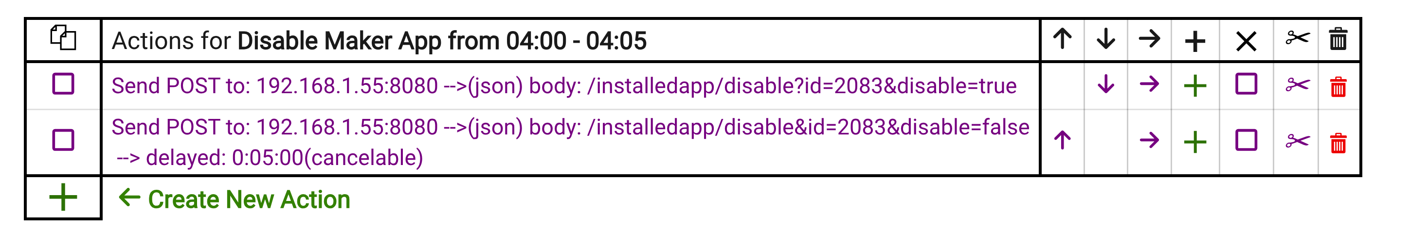

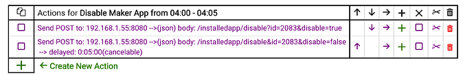

So, I changed the app to be the following:
or:
(I changed it to 127.0.0.1 , and it still didn't work, so I changed it back to 192.168.1.55 which is the ip of the HUb.)
I kept on checking the app list, and it never shows the maker app to be disabled.
(I refreshed the list several times.)

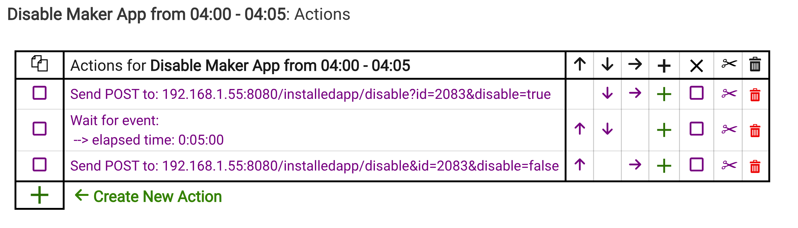

I'm sure this probably isn't the only issue, but in your "false" line, you have a "&" where I think you need a "?" instead.

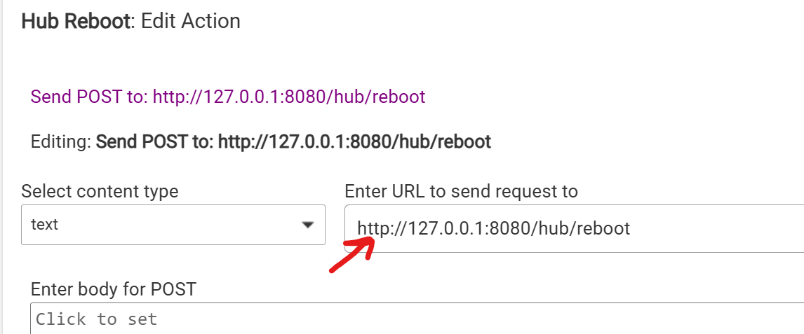

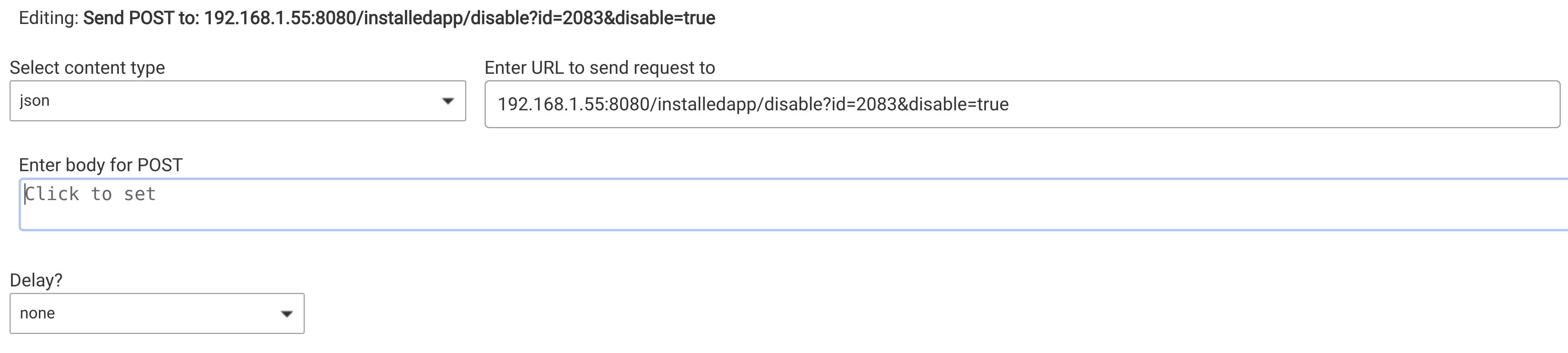

You're missing the "http://" in your URL
example of a reboot command

Thank you, Thank you, Thank you!
I must have missed the obvious, and concentrated on the obscure!
You spotted my error.
