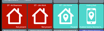

I tend to keep the mode manager to indicate the house’s status (IE it is Day, Night, etc. at the house, or everyone is Away from the house.)
I also prefer to set my own status separately (at home, not at home, etc.). You could track your personal status separately using a Hub Variable and update it with a Rule. It could indicate if you are Home, At Work, somewhere else. Alternatively, some presence devices could be setup for each location like “jnosa899 home”, “jnosa899 at work”, etc. and those could be present or absent based on your presence at those locations.

Owntracks allows me to see 'I'm at work'. I'm at my GF's. I'm at home. You can define location specifics there. I use it all the time... maybe take a peek? It runs on your phone and has been incredibly accurate and stable. the dev who created it also has extended it. might want to peek!

Also, if you are using some sort of presence to detect when you are at work, then you could create a virtual Presence tied to that and just use "work presence" arrives to trigger "work" and "work presence" departs to trigger leaving work. Not sure how you were detecting that though. If you did that, you would not need the switches setup. You would have to be careful though. You might be triggering leaving work when going to lunch if you eat somewhere other than the work place.
I personally prefer the switches as it leaves me a way to easily make a manual override. I just keep the switches on a "Presence" dashboard that is an easy click on my phone.
Manual Presence Dashboard
