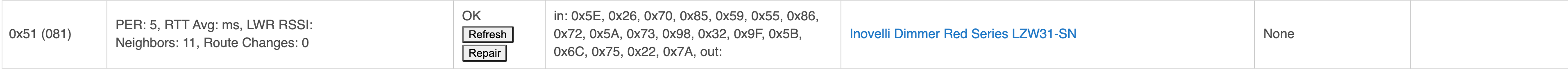

I included 6 devices today and did an exclude/include on a few more. I see one device only has a generic name, Inovelli Dimmer Red Series LZW31-SN. After going through my list of devices I don't see one I didn't name, but I could be 100% positive if I could see what DSK was associated with the device. Is there any way to find that out in Hubitat without say pushing the paddle of every device and looking at the log? It seems the DSK has to be stored somewhere in Hubitat that can be looked up.

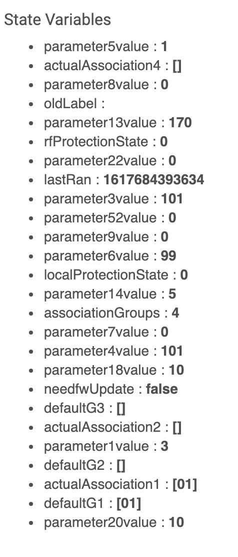

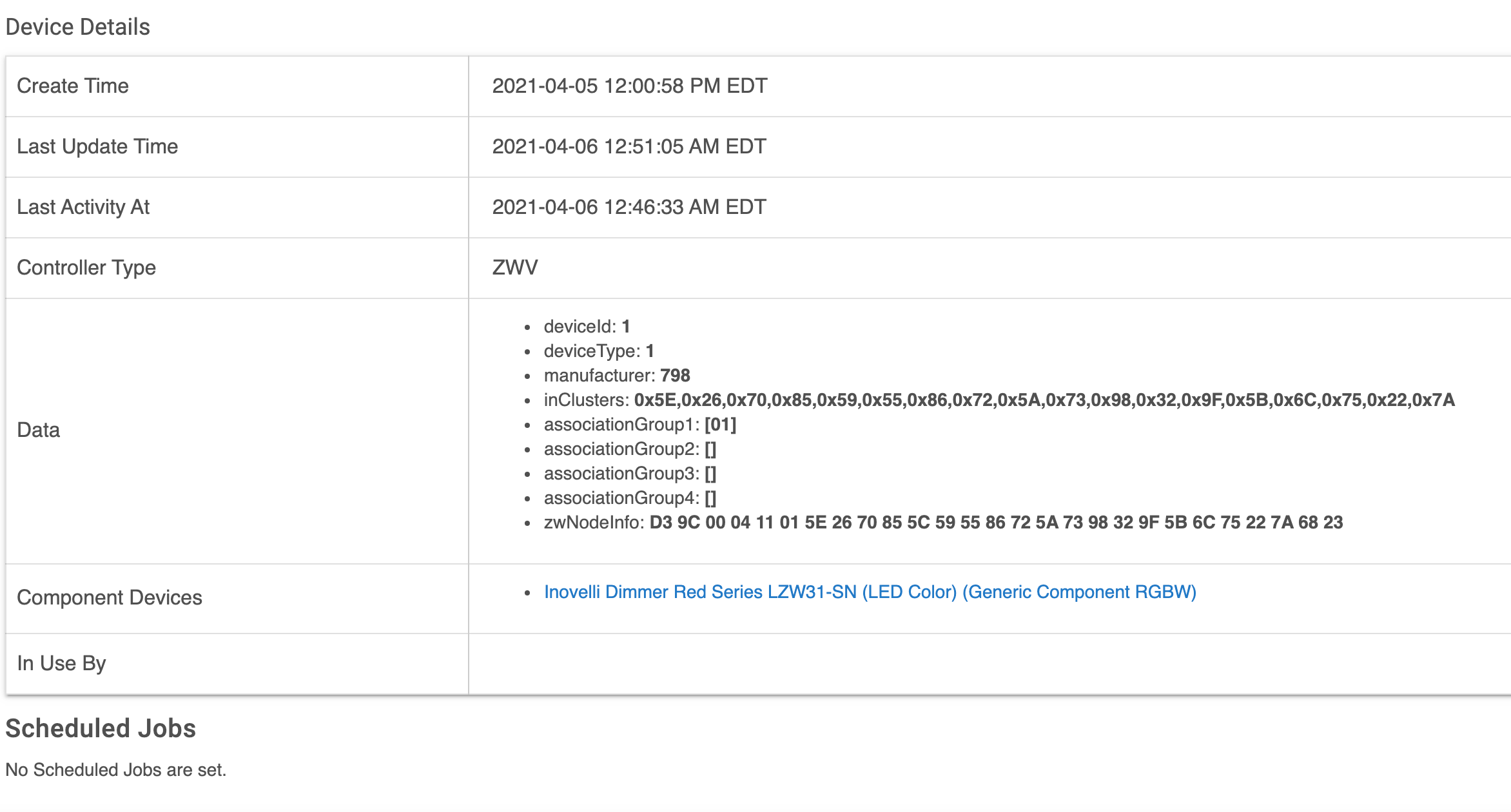

I've seen ghost devices before, and had to clear one today, but I've never seen one with such complete info:

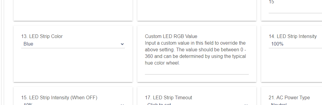

The LED color is a great idea. I've never set the LED before. If I want the LED for the mystery device to Flashing Purple if the light is on or off what params do I need to set that?
If you click on the device name it should open up the device, and if you scroll down into the preferences you should see something similar to:
I did see those. There seemed to be an overwhelming array of choices. I am just not quite sure which to set. I’ll check it out again. I was hoping to have it flash but I think that may be just a notification and not just while on and/or off
If nothing else the LED Strip Color is probably appropriate....

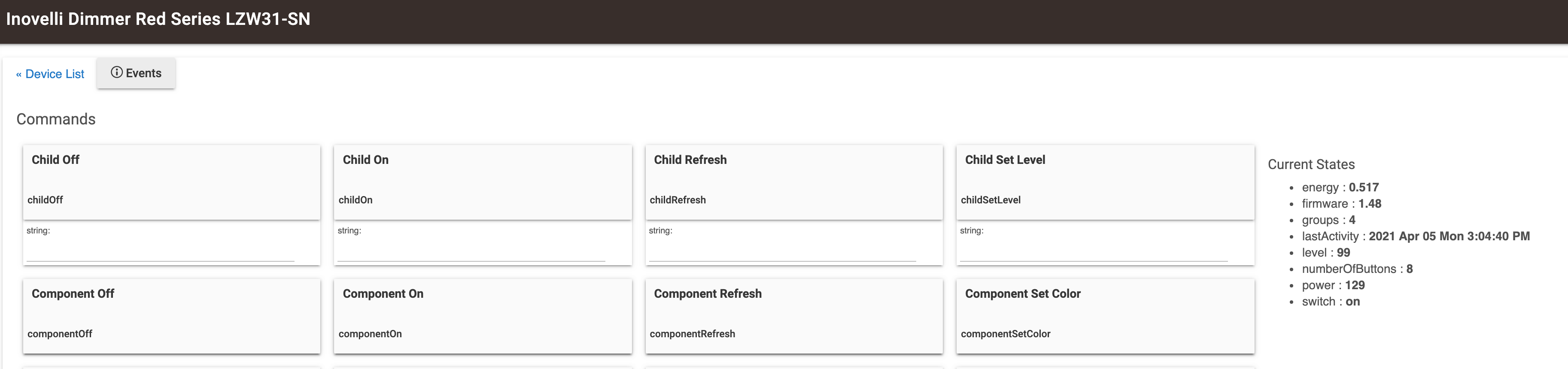

If you're using the "notification LED" child devices, you have to set all four options (in the parent device) before it will create the child device (when you do a "Save Preferences"). That's the only way you could get it to flash besides calculating a value to use with the "Set Indicator" command on the device page--which if you wanted to do that, this tool makes it easy. For example, 67046103 would give you a flashing pink LED bar on an LZW31-SN (double-tap the config button to cancel once you find the device in question, or send a "Set Indicator" command again with a parameter of 0).
But to just change the "regular" LED color, either "LED Strip Color" (as suggested above) would work, or "Custom LED RGB Value." They are both the same thing, and if a custom value is provided it will override the other selected value ... so I'd just make it easy and choose something besides "Blue" (or whatever you might have others set it) from the drop-down. Or do the notification LED like above to make it fun. :smiley:

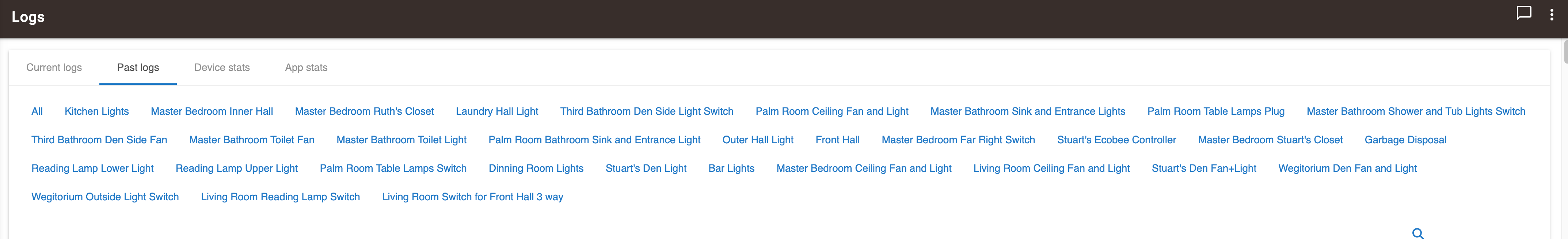

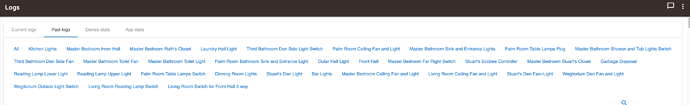

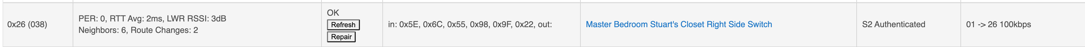

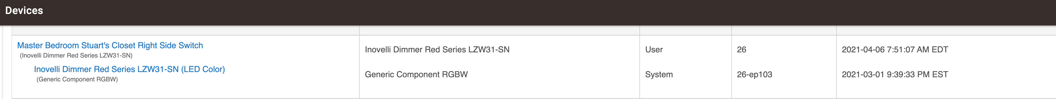

However, there was one device that was non-responsive. I went into the Logs and it didn't show up when I pushed it. In fact, it wasn't even in the old logs. (It is Master Bedroom Stuart's Closet Right Side Switch)
But it was listed on the Devices page and on the Z-Wave details page.
I tried to exclude it but couldn't. I tried a "refresh" but that did nothing. When I tried "repair" it showed up as going faster:
But yet still wasn't in the Logs and it was still non-responsive.
So I did a hub shutdown through Hubitat and then left it unplugged it for 5 minutes. After I plugged the hub back in and waited for it to come up I was able to do an exclude/include on this device.

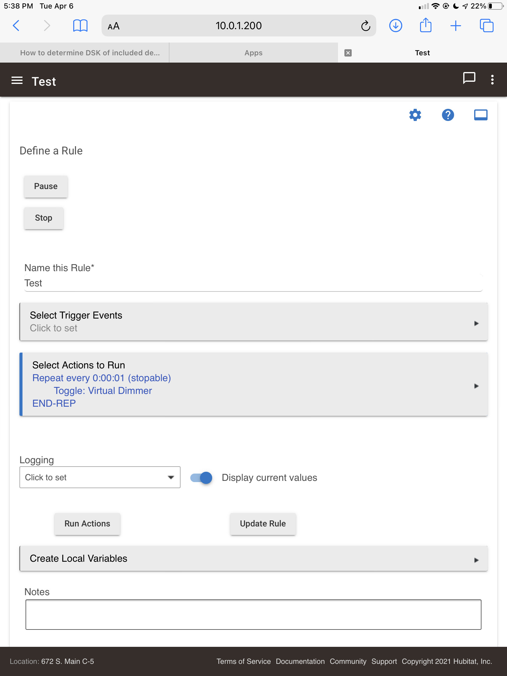

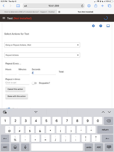

Have you tried a simple rule to toggle the dimmer on and off, with a toggle rate of a couple of Hz or so? That should be easy to spot, just walking around.
I'm not sure how to do that. Is that a Button Controller? What is the trigger?
Nope, just do the rule, no trigger, run actions and let it fly:
Ding, dong the switch is dead! Which old switch? The wicked switch. Ding, dong, the wicked switch is dead!
I just upgraded to 2.2.6.139 and went back to my Z-Wave devices table. This time the device was still there, but there was nothing in the last column for its path and speed. When I did a refresh this time I did get the option to remove it. I had to click Remove 2 times, but the 2nd time was the charm and now the device is gone. Gone with the wind. (to mix my 1939 and 1940 movie references out of chronological order)

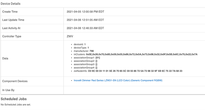

Here is how to get what I had:
Thanks!
