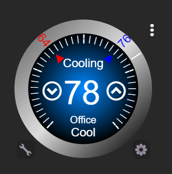

The goal behind all of this was to create an attractive thermostat using Tile Builder. Not quite finished but it looks like this.
