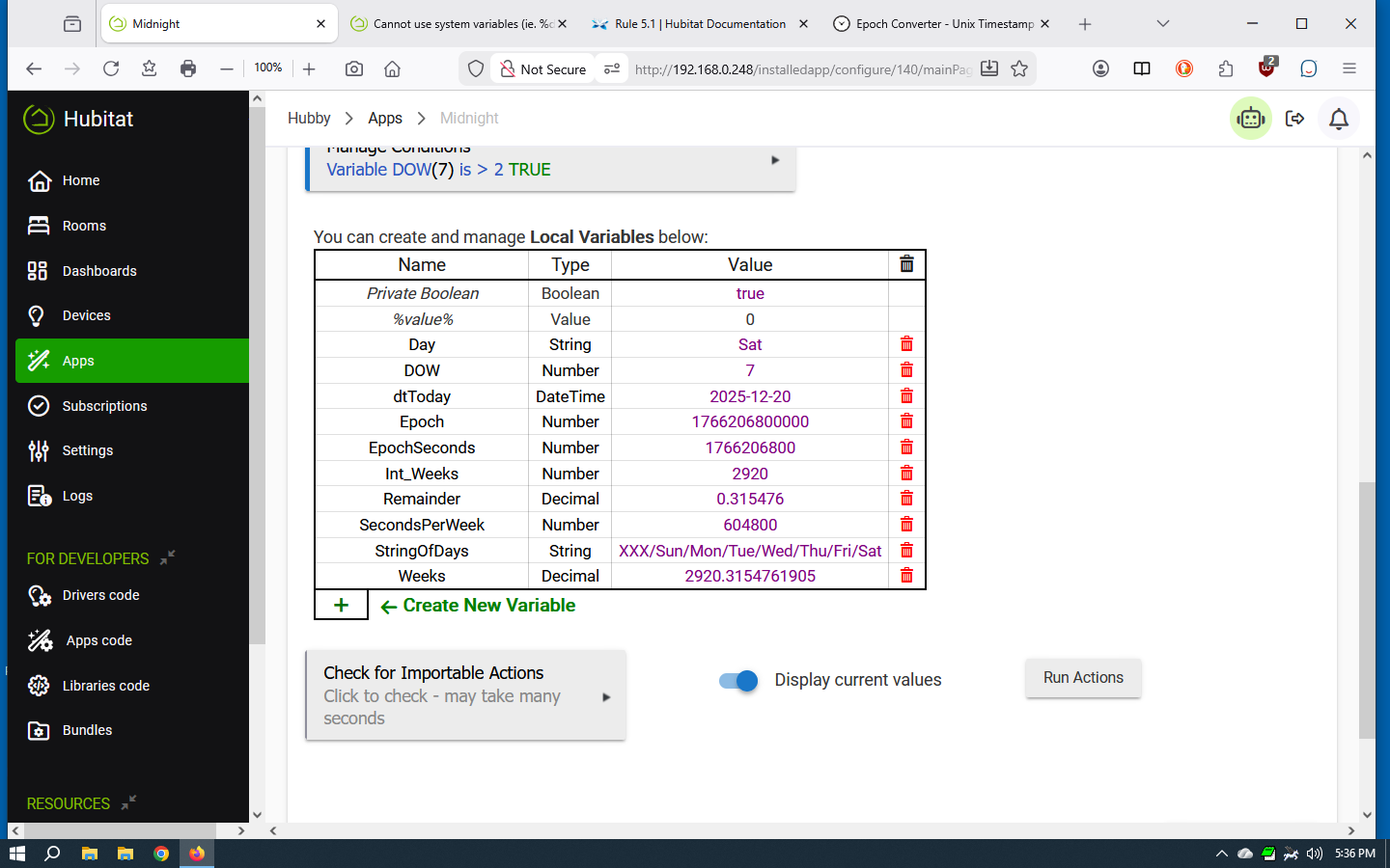

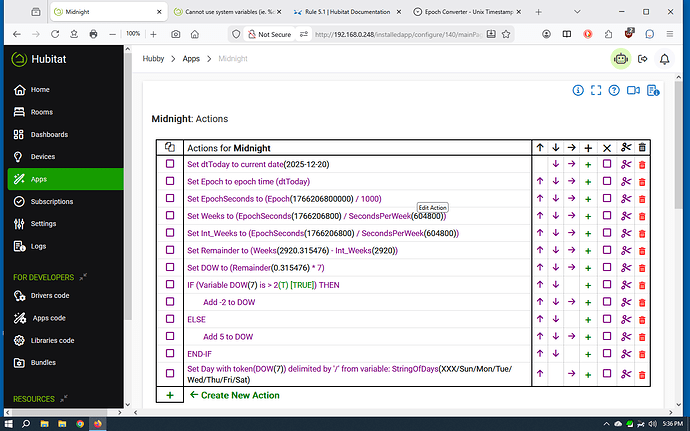

Searching for Day of Week string, I was surprised that it is not built into Rules 5.1. So far I have avoided having to do anything outside of 5.1. I may have taken some extra steps, but I wanted to make things clear to anyone using this code.
See screen shots below.

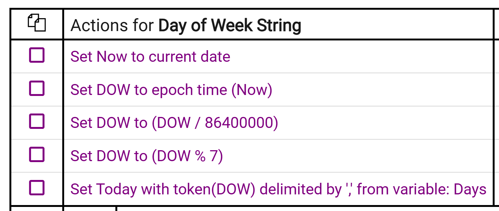

In the spirit of consolidation without obfuscation, I offer this somewhat condensed version of the OP rule, which seems to work:
The variable Now is of DateTime, while DOW is a number and Days is a String as follows:
The above info and solutions are great/clever--well done!

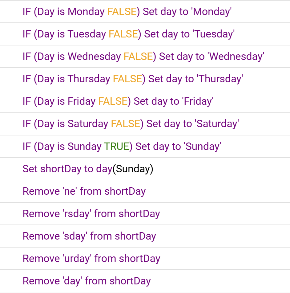

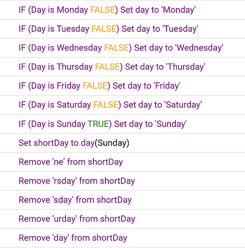

As an FYI/alternative, here's another approach including a short day string that I use:
Thanks for your cleanup. I did not see the "%" operator in the list. In that I plan to use DOW and Day_Of_Week in other places, I choose to keep things in what seems logical to me. Here is what I came up with:
Set dtToday to current date(2025-12-21)
Set Epoch to epoch time (dtToday)
Set DOW to (Epoch(1766293200000) / 86400000)
Add 5 to DOW
Set DOW to (DOW(1) % 7)
If DOW = 0
    Set DOW to 7
Endif
Set Day_Of_Week with token(DOW(1)) delimited by '/' from variable: StringOfDays(XXX/Sun/Mon/Tue/Wed/Thu/Fri/Sat)
This way, I can have global variables DOW and StringOfDays, use them in other routines, and read them as my mind expects them to be.
