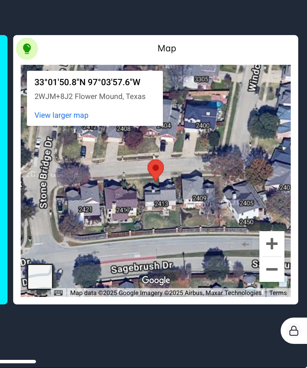

I did take a crack at this:
That was using:
However, if my hubitat device's lat/long changes, I can't see this reflected in the sharptools tile unless I do a screen refresh.
Additionally, the zoom is a problem and the tile isn't clickable.

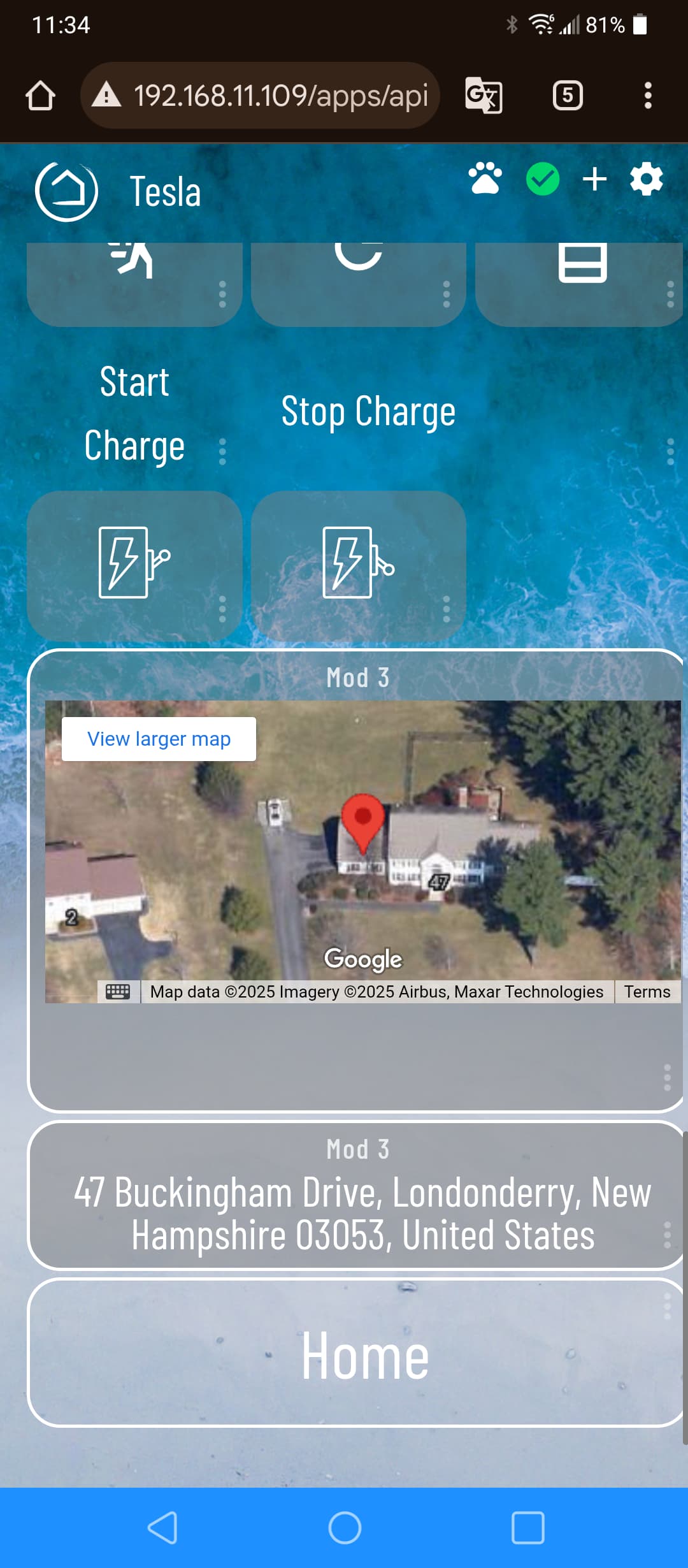

Is anyone using a virtual Image device to display a google map on a dashboard? If yes, what is the URL string you are using?
I’d probably look at using the Virtual URL device with the type set to iframe instead.
def updateIFrame() {
    def lon = device.currentValue('longitude')
    def lat = device.currentValue('latitude')
    if (lon == null) lon = 0.0
    if (lat == null) lat = 0.0
   sendEvent(name: "zzziFrame", value: "<div style='height: 100%; width: 100%'><iframe src='https://maps.google.com/maps?q=${lat},${lon}&hl=en&z=19&t=k&output=embed&' style='height: 100%; width:100%; frameborder:0 marginheight:0 marginwidth:0 border: none;'></iframe><div>")
That format will work with the Virtual URL device
