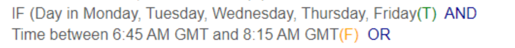

Something like this. Use a condition with days of week and time of day. This would announce on one device Monday thru Friday from 5 to 9AM and on two echoes all other times.
Thanks, was trying to do something like that but had a hard time with the UI, not the language itself. Got part of it working now but still cant work out a seperate weekend OR statement.
If i try to add an OR after the IF Days of weekday/time so that i can have weekends/time also it moans about ending operator?
Think i got it, UI misunderstanding again.
Does this look ok?
You probably need to add parenthesis into your if. Edit the actions and then edit the if statement. Then click edit expression. In that area you can click "insert before expression element". You can then add a opening "(" before Day Sat or Sun, and then add a close ")" at the end.
After you add the first "(" it will give you a error but as soon as you add the final close ")" it will be okay.
like this?
What do they do?
It groups the statements.
IF (X AND Y) OR (W AND Q).

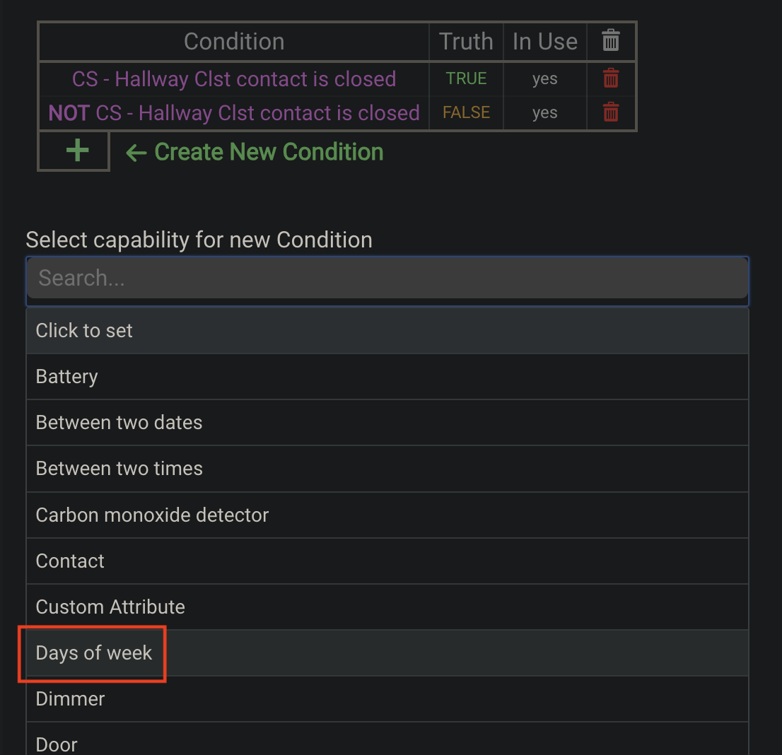

Has the "Day" condition been removed from RM?
Im trying to write a rule that has an exception for sat/sun between certain times and the only options I can find are based on specific dates. eg "On Day", and "between 2 dates".
It's still right there for me...
Thanks, Im clearly going blind! :man_facepalming:
