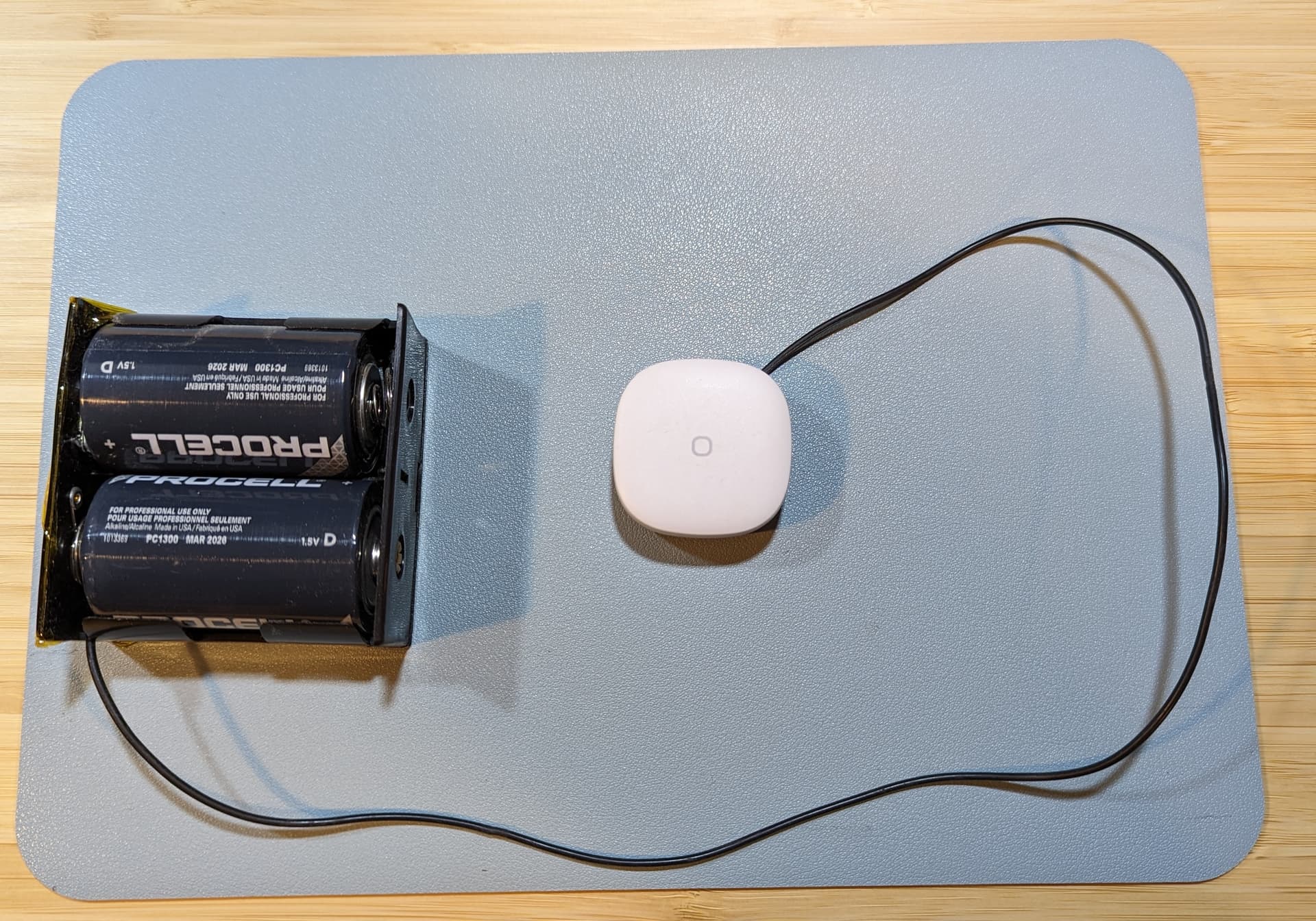

Or just run external batteries. This 2 D cell batteries on a smartthings button still at 100% after 2 years.
Wow I wasn't sure they even sold "D" batteries any more /s
