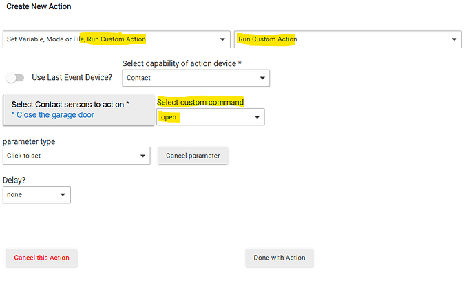

However, I (and some others) have come to the conclusion that switch/contact or switch/motion devices aren't totally reliable on the Amazon side. I don't know why, and like all things Alexa, there is no consistency. But I've been changing mine to contact devices only and have never had an issue with contact only.
The only difference is that on the Hubitat side, you use a custom action to set the contact to open or closed as desired. This may not seem as natural as turning a switch on or off, but it simplifies things on the Alexa side.
Can you tell me how to do that? I couldn't figure it out.

Opening/closing a contact is easy (as shown above).
