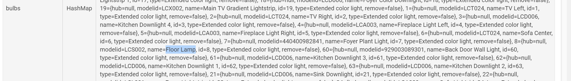

When I look at the settings for my Hue Integration App, I can see the Floor Lamp's network ID. I then tried to create a virtual device and change the network ID to that of the Floor Lamp. However, when I try to change the network ID to that of the Floor Lamp, Hubitat tells me that the network ID is in use and to try using a different ID.
In sum, I have an old and new Hue bulb using the same name. I deleted the bulb in devices. The new bulb is working in the Echo Skill via the Hue Integration App. However, I cannot add the bulb to any automation tasks as the bulb is not in my device list. I know the network ID of the bulb. Any thoughts on how I can add this bulb to my devices manually?

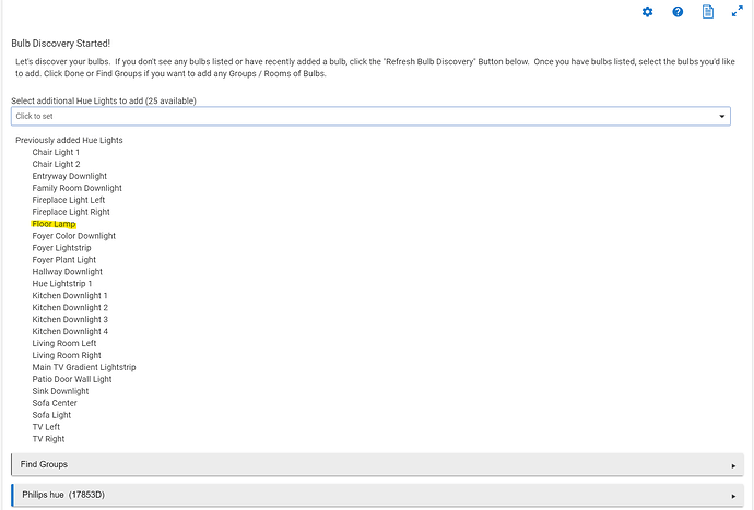

It's likely that the Hue API has retained the removed bulb and you just added the old one back instead of the new. I suggest removing both again, then go to Hue Integration and let it search for new bulbs. It may help to change the name of the bulb in Hue app just to make sure you're selecting the new one.

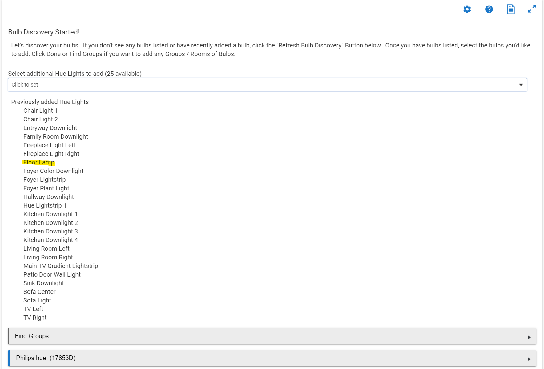

Floor Lamp is present in my Hue Integration app though
And in the settings for the Hue Integration app, it lists Floor Lamp with a network ID of 8.
Is this possibly just a "ghost" device listing then?
Regardless, I will try to add the bulb again with a different name. Thanks for any additional insight. I do appreciate it.
They'll go away once you remove them from both Hue and Hubitat Devices page (check Devices to make sure the Floor Lamp has been removed).
