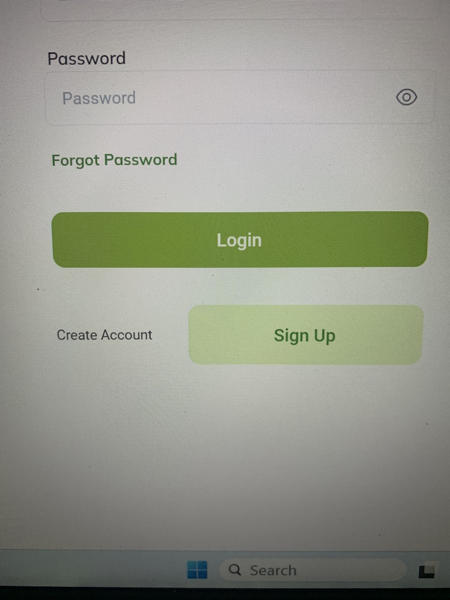

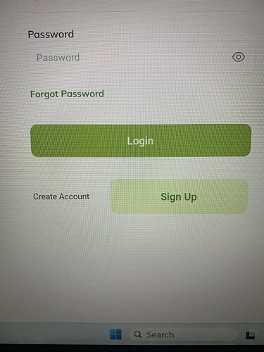

On my cell, instead of login I want to use Create Account as suggested. But it’s not a link. What am I missing? Thank you.
Ps my goal is to install the app on wife and son phone allowing them to only turns lights on and off
This page was just revamped, and I think that's an issue with the new page.

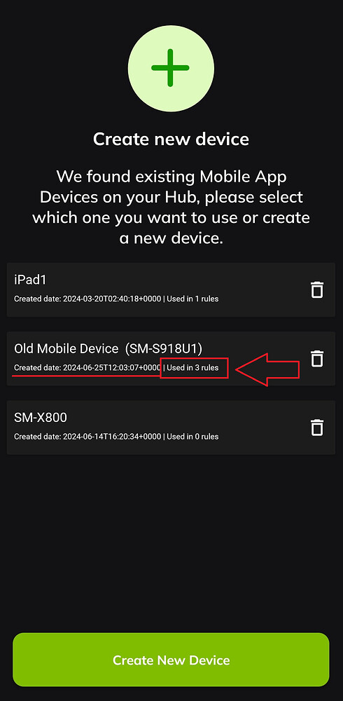

To enable separate push notification and/or geofence/presence, you will need to create a new device from their phone during the initial set up, when you see this screen:
