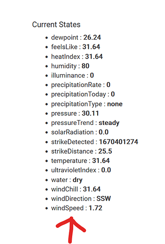

rlithgow1 - thanks I think I found the proper five digit station ID and have it entered. I can see in my device list when I click on Tempest a handful of reported values such as wind chill, and feels like. Do you know how I can get wind speed reported into my Hubitat device? And then how I would be able to schedule alerts or rules once that certain windspeed has been reached?
aaiyar - I used the Bond app to add the Bond into my device list. When I open Bond within my devices, I see a box titled configure, and when I click on it, it turns from white to gray, but nothing happens. There is a similar box that says refresh right next to it. I cannot see any of the shades that my Bond controls within my Hubitat and Bond app. So it looks like I have something more to do but I am stuck as to what would be the next step? How can I find my shades within my Bond device?
Wind speed is in there.. (I assume you're using the weatherflow light driver)
Just use custom attributes as the trigger when creating the rule and when you pick the device, all available attributes (see above) will be available to choose.

OK the wind speed showed up so I guess I just needed to allow it to populate. So I created a basic rule to notify me when the temperature dips below 60° on my iPad. How will it notify me? And the temperature was already below 60 when I set this rule, so will it do anything?

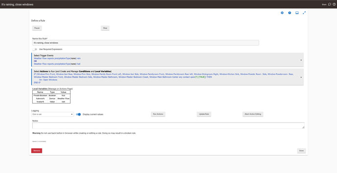

Rule Machine is much more complicated than Basic Rules, so it depends how exactly you configured the rule. It's possible that every single time the sensor reports all values above your threshold, the rule will send a notification. The only way for us to know for sure is to see a screenshot of your rule.
