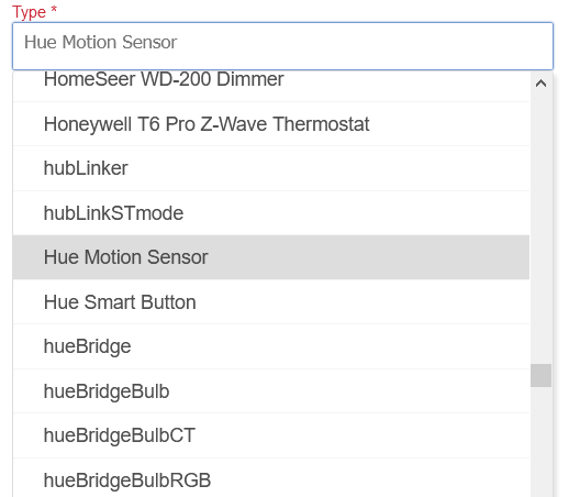

Good point, I was thinking of what sensors I have used lying around and didn't realize the hue ones have temperature. I just got a Hue Outdoor Sensor earlier today which is weather proof. I don't see any of my hue motion sensors showing up in Hubitat, only the hub and lights. How do you setup a hue motion sensor in hubitat? I just got the hubitat a couple days ago and am figuring a lot of it out transferring all my devices from a Wink hub. I have the Hue app installed.
I don't know what the Hue app is, but there is a in-the-box Hue Motion Sensor device driver in the dropdown.
Cool thanks, I'll play around with it. I haven't used Virtual Devices yet. I pulled in all my Hue bulbs as devices by installing the built-in Hue Bridge Integration app but that doesn't show the motion sensors as devices.
Hue motion sensors can be paired directly to your Hubitat hub. Hue doesn’t expose sensors outside the Hue ecosystem, so there’s no way to integrate them into another platform while they’re paired to the Hue Hub.
I would move any Hue motion sensors you have over to Hubitat. You’ll be able to do a lot more with them that way.
