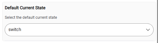

I have written an app and drivers and I am trying to figure out how to set the defaultCurrentState for switch devices to "switch" and for dimmable to "level" but I can't seem to find a way to do it via groovy.
This is the setting I want to set by default but I can't seem to figure it out.
You can't; this is a "pseudo" preference generated by the hub and only settable by the user.
Thank you so much! That was my assumption but I couldn't prove that was the case.
