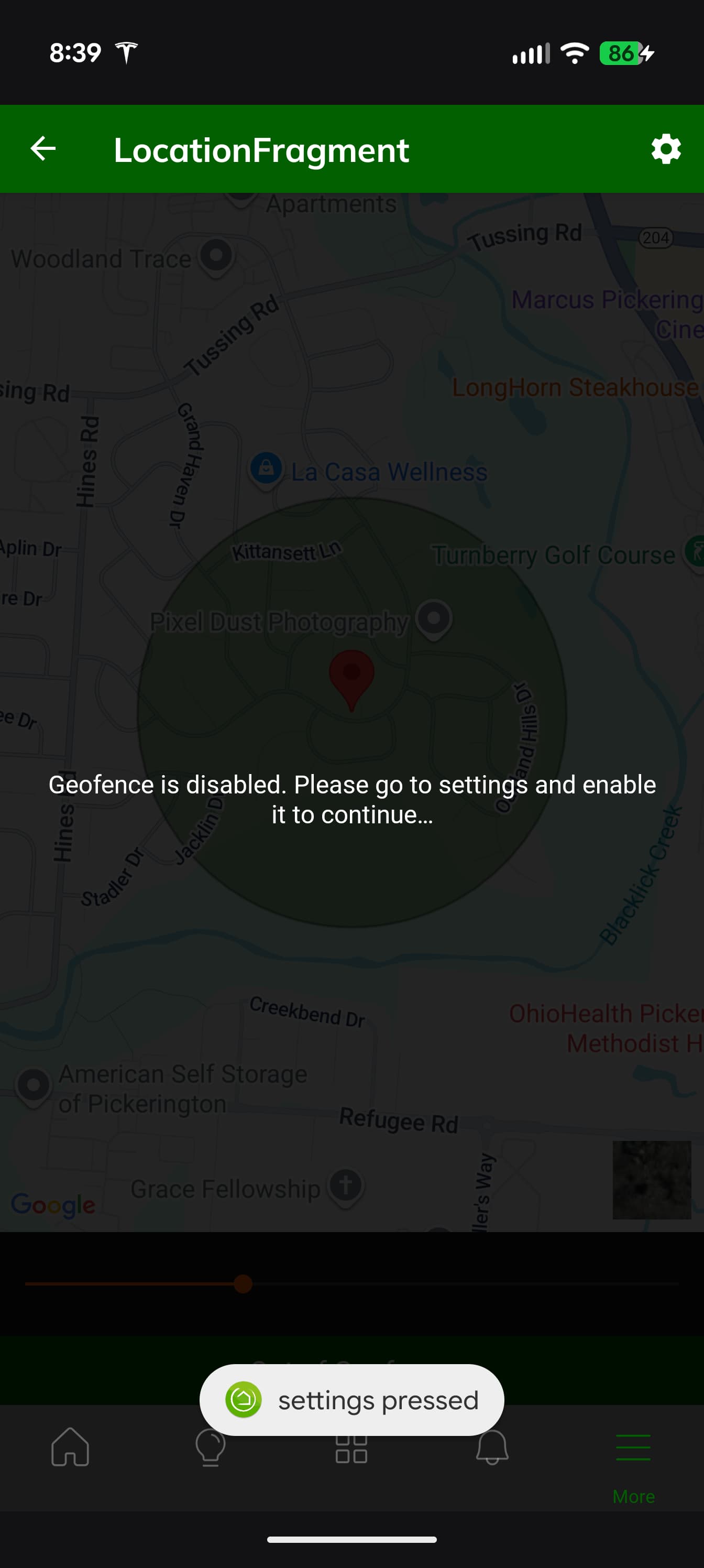

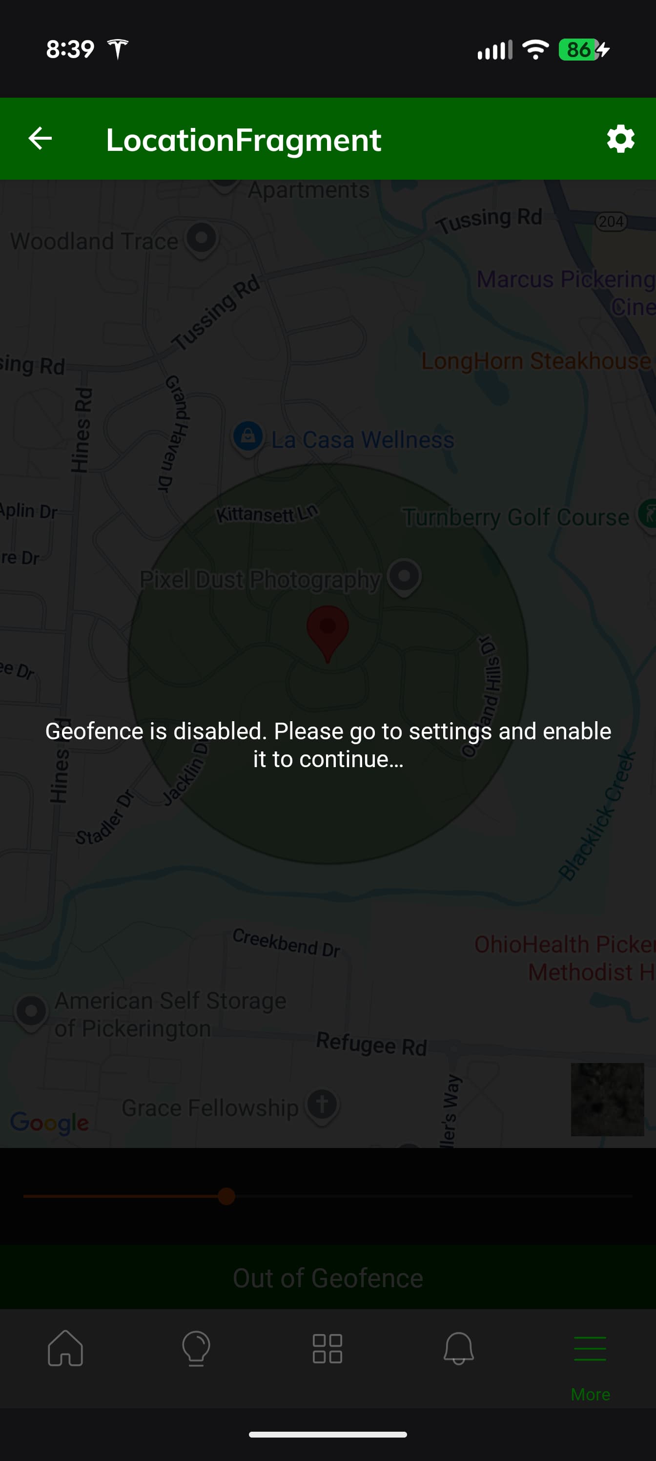

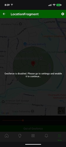

New phone, new app. There doesn't seem to be a way to actually enable geofence.

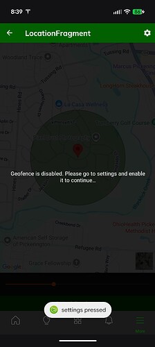

Clicking the settings gear does nothing other than a pop up saying you clicked it
Nothing in app settings either.

From the last screenshot it looks kike 2.1.3.42

Thank you for the reply, but as stated on my OP, clicking the cog does nothing other than show a pop up today saying "settings pressed" see second attached image in OP.
