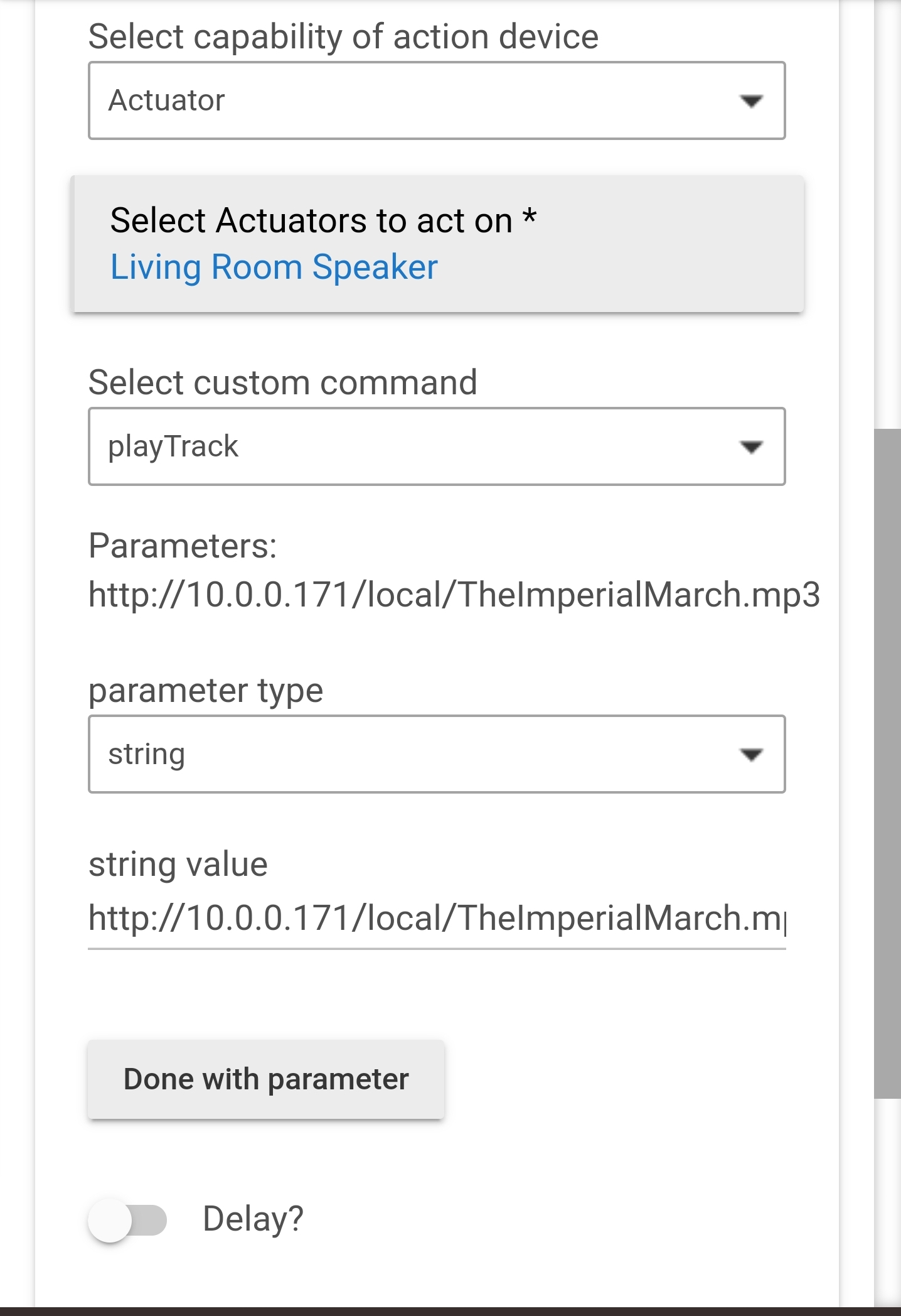

Use rule machine, see example below.

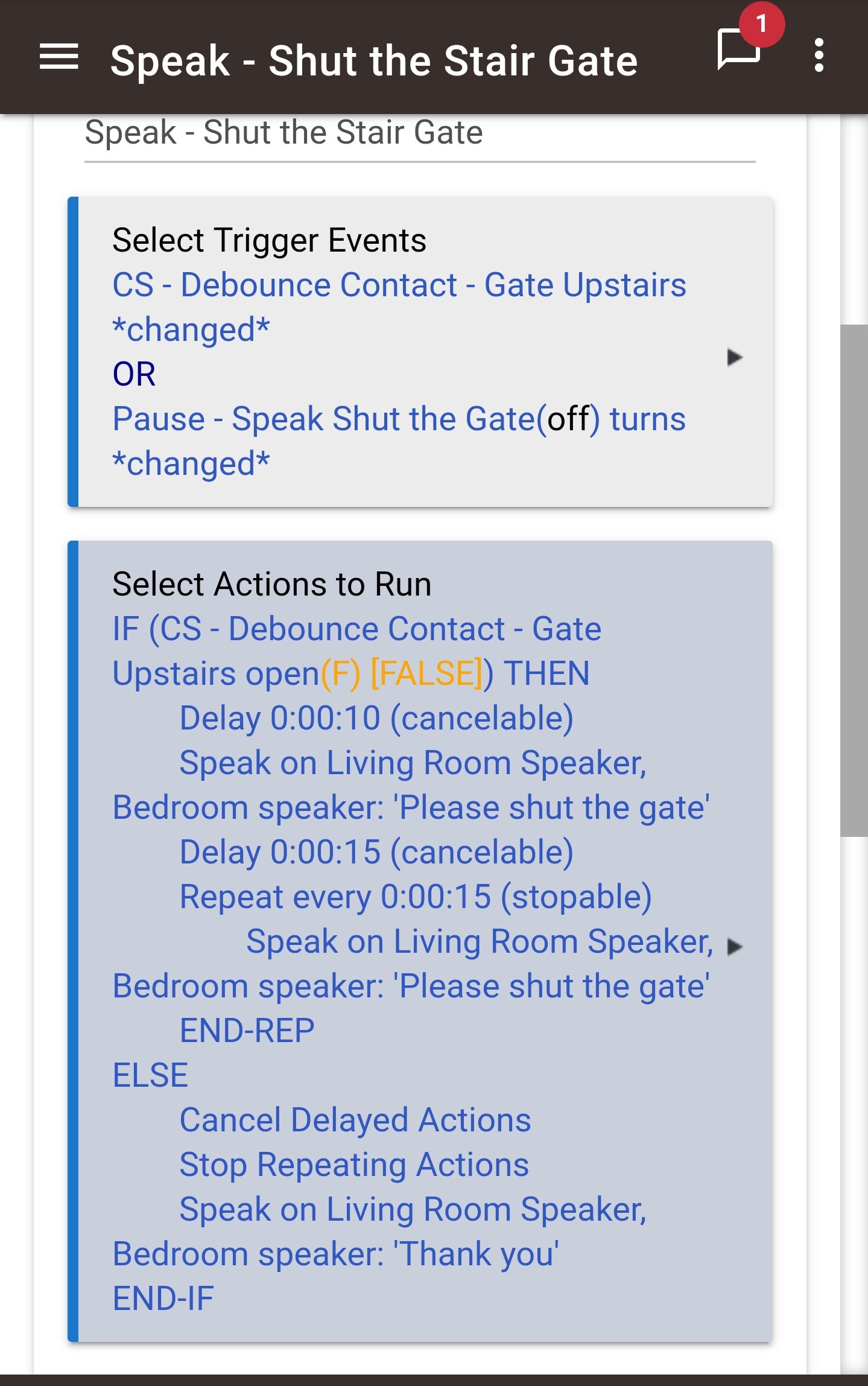

You can peace together the rule using what I showed above and this rule:
Closest I already have to what you need, but a good framework for the rule.

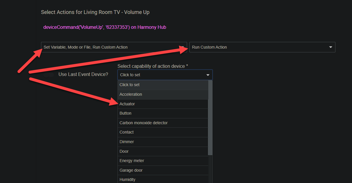

My rule machine doesn't have any of these options. No place to select Actuators...etc... Can you explain how you got this menu?
When you are adding an action, select the option that includes Custom Action, select Run Custom Action from the drop-down list that appears, then select the Actuator capability, then the device, command to run, etc, etc.
Got it working... Thank you!!!!
