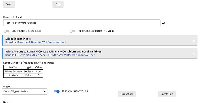

What I Want to Do: I want Hubitat to send me an email telling me that - in this case - my leak detector under the kitchen sink has detected a leak.
What I Tried: See the attached screen shot. I am sure I am doing this wrong, but don't see a way to send an actual email. (the address shown is a dummy as I don't know how to draw lines through things in a jpeg using a Mac.)

You need SMTP (or a service that does so on your behalf, which I'm guessing doesn't exist in your setup), not HTTP POST, to send email. The easiest built-in option for this is webCoRE, which has built-in email sending capabilities. There are also community options that may work, depending on your e-mail server.
