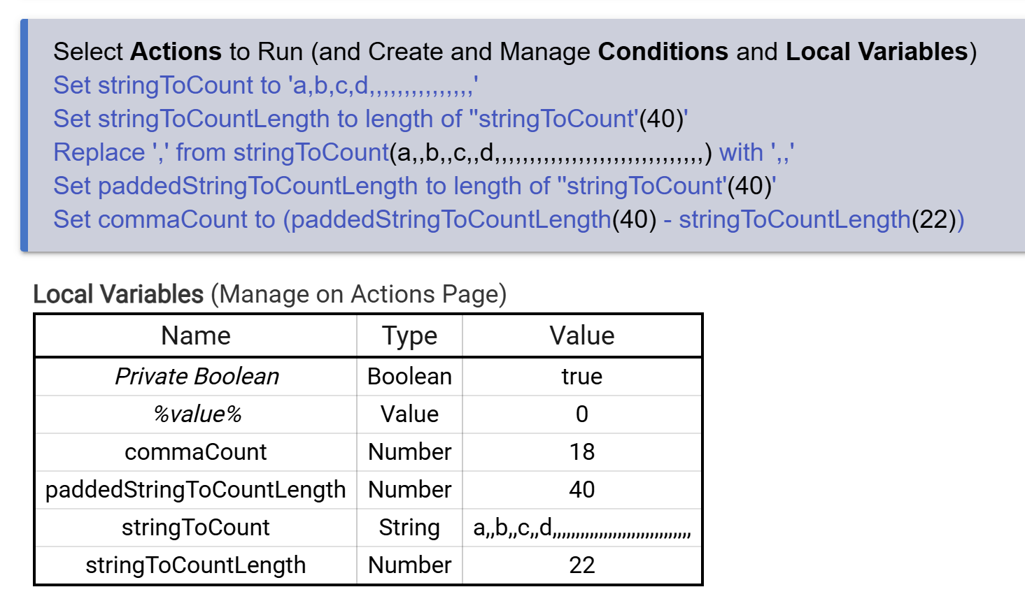

But I'm stuck at step 2. The string Remove command only removes the first instance of the chosen character. Interestingly, the Replace command will work on all instances of the character.
Is this a bug? I've attached a test rule that shows this issue.
Here’s a unique approach.
Replace all commas in string with XX.
Now find the difference in string lengths…. Voila!

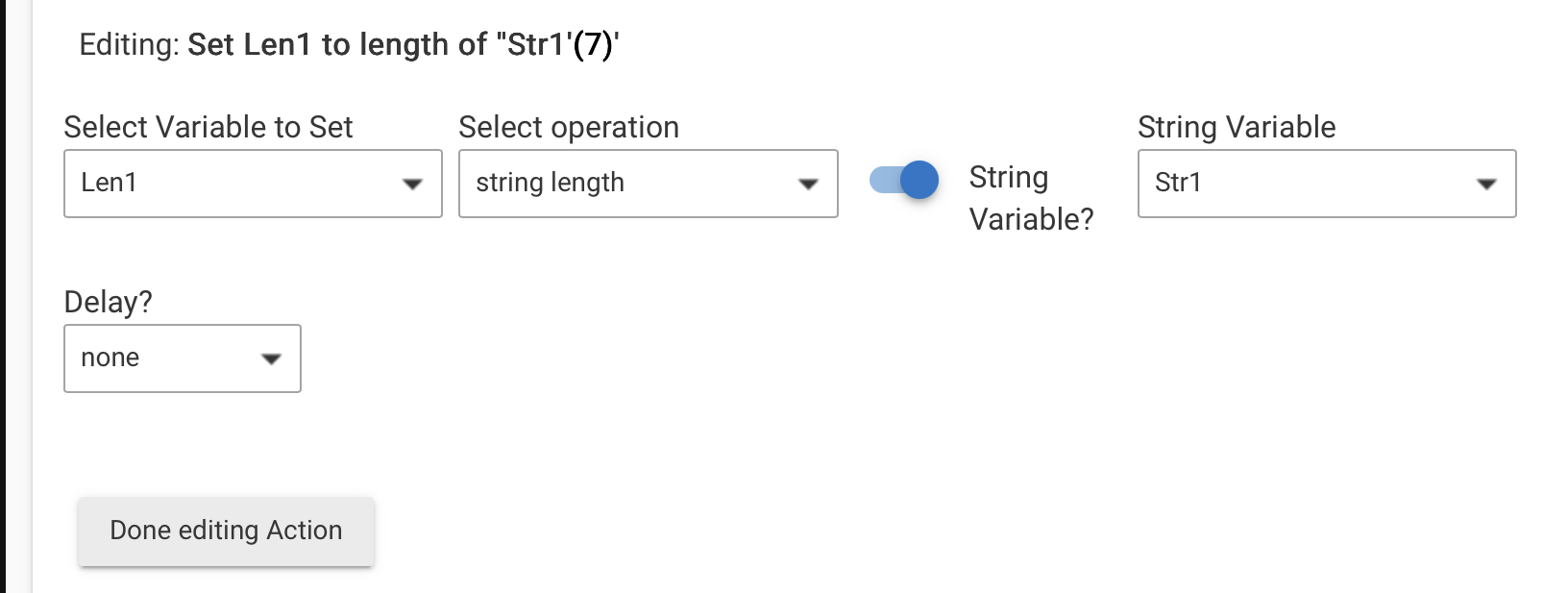

Is there a way to get the length of a string in RM? I didn't see one?
This is a good workaround. And the divide by two is not needed.

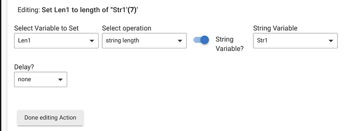

It is an option for theā€set variableā€ action.
Never had a need to do that, but I looked and didn't see it, but it is there.
