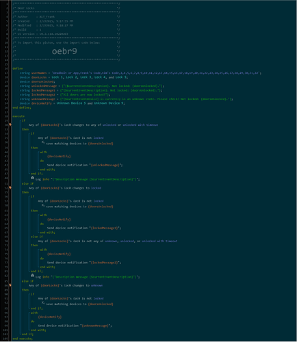

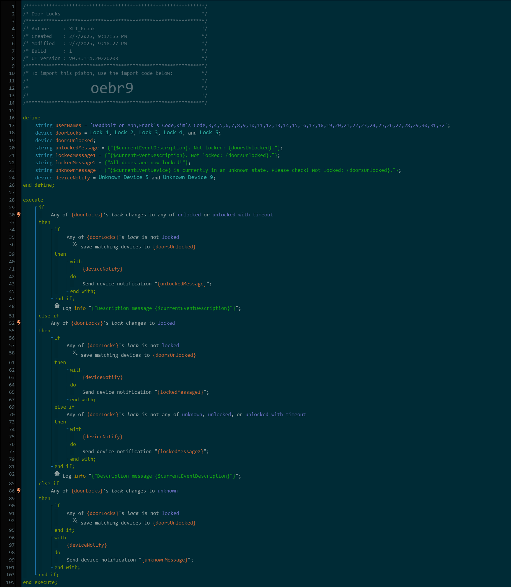

With great difficulty. String concatenation is the general idea if you want to try -- but because it is so difficult, I ended up writing a custom app. I've shared that here if you're interested, but if you want to try the Rule option, you can find an example of the rule it replaced there, too:
