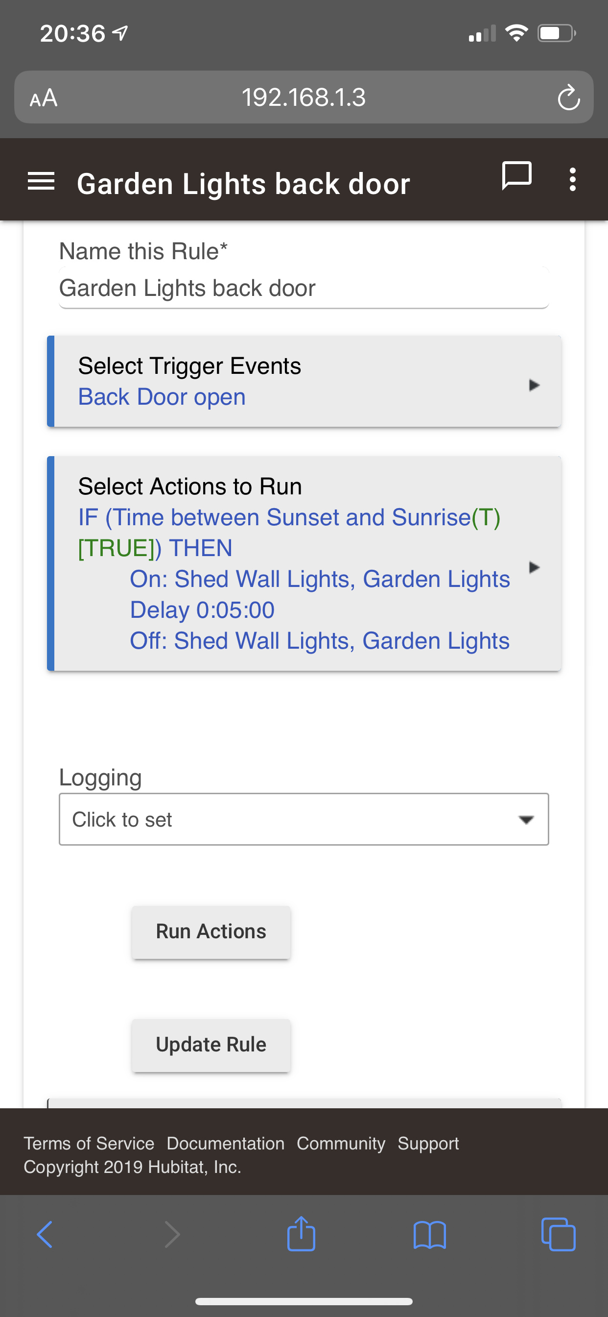

How do I overide a rule
How do I overide a rule if my garden lights are already on

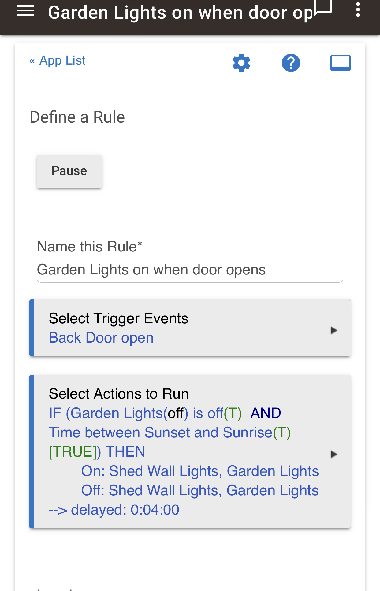

Is it because my aqara no neutral light switch is showing up as a button I can't select it
image image image
You want to look at the child device, Garden Lights. That is what you have to check whether it's one or not. Isn't that the one that you are turning on or off?
And all you will do is create another condition of the lights being off.

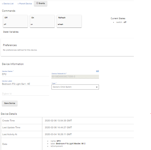

Just to follow up what @Ryan780 has said, did you generate a child device by pressing the "Recreate child Device" button. This is what you should be using in any rule.
When I go to a condition I can't see a option for a child device I've looked under all options
Have I added my aqara switch correctly

You just select switch and then select Garden Lights. Just like you did for the action.
You can see in the screenshot that the devices are created. Also, she wouldn't have been able to select them in an action if they weren't installed.
I have these switches and the screenshot shown is not of the child device. It is the parent device.

Exactly. That's the problem....the child device is what should be used to check if the child device is on or not, not the parent device.

Okay....do you know how to create a condition? Select the switch capability and then find Garden Lights.
That's not the right screen then. Conditions are not controlling anything. I would review how to work with conditional statements again.
I'm such a dimbat I was looking for Name EP3
When I should of been looking for the Label instead
Thanks for all you help guys
