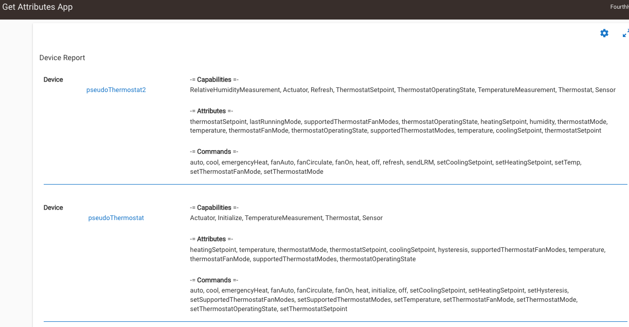

To compliment @csteele's nice little App (that I didn't know existed
), there is also the capability documentation, which includes both the attributes and commands for each capability.
But I expect if you want to cover all possibilities, adopting the approach @csteele took in his app will cover all eventualities.
Actually, @csteele, will the app pick up all attributes using ${v?.supportedAttributes}? Or just the ones covered by the capabilities supported by the device?
I have no examples of a "hidden" attribute to test against. I am forced to assume that ${v?.supportedAttributes) is adequate.
I created this when I was working on HubConnect stub drivers and needed to match a "real" driver with a virtual driver written to that spec. I've written lots of virtual drivers trying to mimic the offerings of real drivers. In the above example, for a thermostat, I wrote a more "detailed" virtual driver trying to cover features of that Honeywell driver I support that my "real" thermostat doesn't contain. We don't use Humidity or Emergency Heat in California, for example. I haven't bumbled into a missing attribute... yet.
