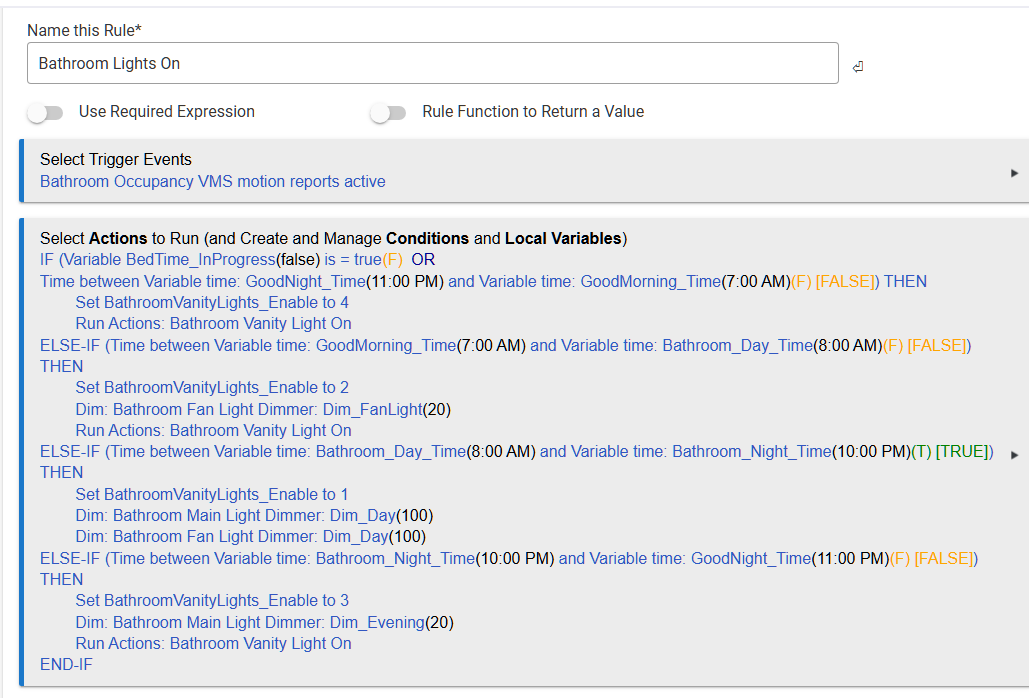

I have a RM Rule which turns on Bathroom Lights:
According to the logs/timestamps the delay between Trigger and Lights ON is subsecond (second ELSE IF in the rule). Both Lights (one is ZWave and second one iz ZIGBEE) turned on simulteneusly (visually) but with a delay 2-3 seconds from Trigger Event. Since both lights on the different mesh, mesh behavior is out of question (my good guess).
The question is:
How do I debug (find out) who is responsible for the huge delay?
UPDATE
There is another variable in equission.
