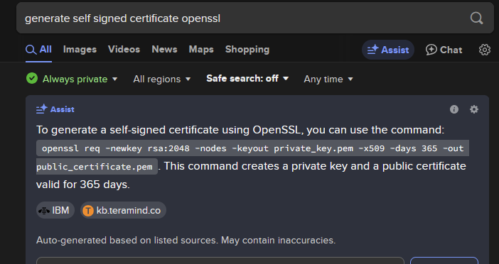

there...one liner:
To generate a self-signed certificate using OpenSSL, you can use the command: openssl req -newkey rsa:2048 -nodes -keyout private_key.pem -x509 -days 365 -out public_certificate.pem. This command creates a private key and a public certificate valid for 365 days.
