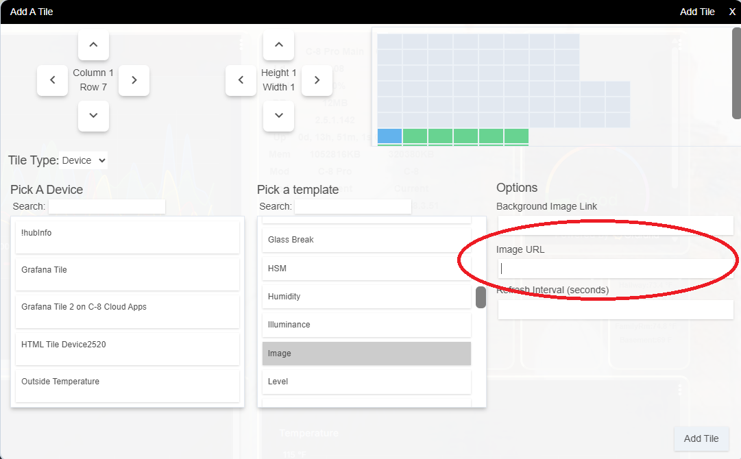

Legacy dashboard - Add the image URL - done
A new template for RTSP device would make this easier as well. I have the device, add it to the dashboard with the NEW RTSP template and then it auto populates the image data from the device.
It should be
Pick a device: The Camera
Pick a Template : RTSP Device
that is it. having a user type somethign in that should just be able to be selected makes it usable for the average user, typing in a whole string is not what you want to do if you have a few cameras that you want on a few different dash boards.
Sorry, my Photoshop skills are Nill. but thats it.. just like every other device that exists. pick it, pick the template, profit!
