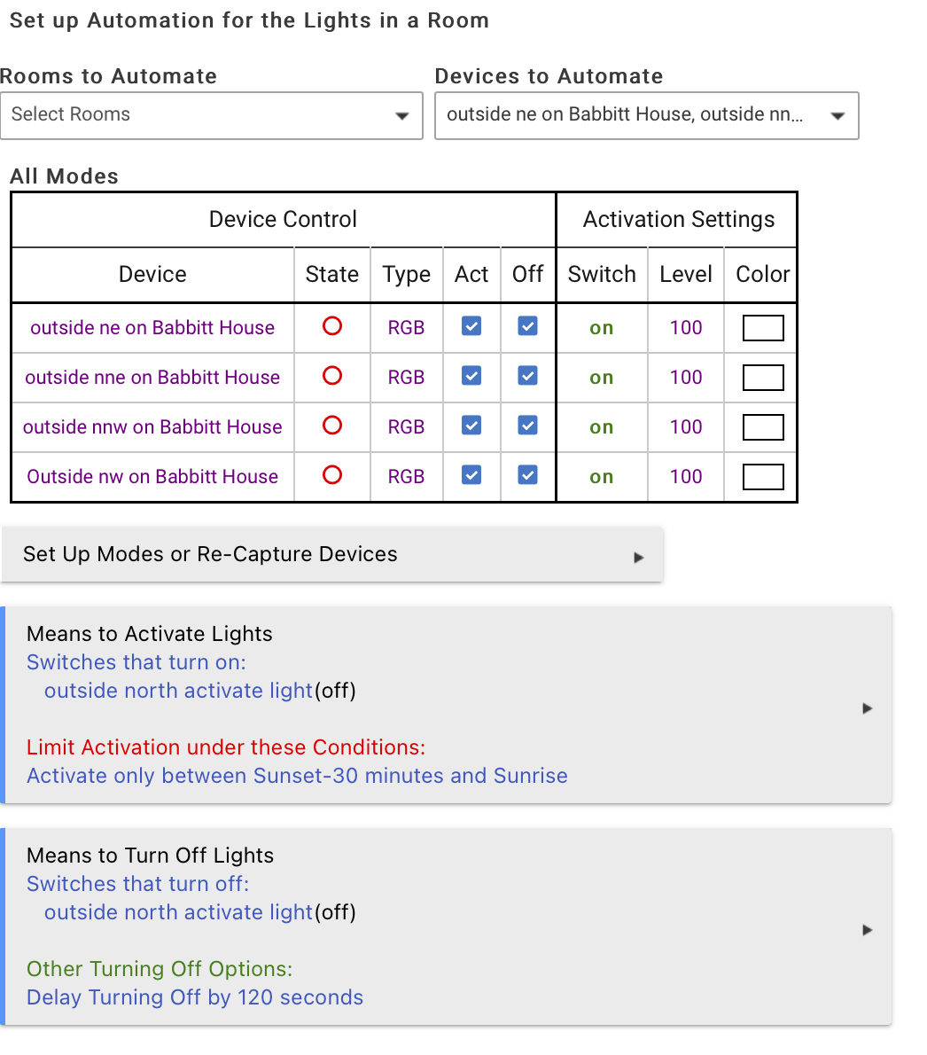

The easiest way to do what you want is to create a virtual switch for each function you want to initiate, then create a rule using either simple or basic rules... or you can use the new "room lighting" app... or if you want to go crazy you can use Rule Machine. Using any of these tools you can have the switch active the automation by turning on and deactivate by turning off. Or you can have it activate by turning on and then automatically turn off after X, or any number of other ways to turn them off. You can also add the virtual switch to a dashboard. Then go into the Alexa app and create a routine that turns on (or off) the switch on command. Or if you dont want to bother with a routine in the Alexa app you can just say "Alexa, turn on X" where X is the name you give your virtual switch.
Here's a really basic example that turns on my outside lights for 120 seconds when a virtual switch is activated, but only between sunset and sunrise. The virtual switch can be turned on with Alexa, with a dashboard, or through other rules (not shown) by my camera system or by motion sensors. My virtual switches turn off automatically after a second - I really only use them to trigger various rules.

Basic rules and virtual switches is a good place to start for many beginners, but Scenes app might be a bit easier here in my opinion. You would set up the scene with things set to particular colors and dimming levels, and it would automatically create a virtual device (Scene Activator) upon saving the scene. You would expose this virtual switch to Alexa, or a Dashboard, or even use it in a time based rule. https://docs.hubitat.com/index.php?title=Groups_and_Scenes
I think the newer Rooms app is a great choice too, it might not be the easiest to understand for beginners, to me it is a more intermediate level app than a Basic Rule would be, but it is a very powerful tool that can do a lot of things in one app rather than spread into various apps. This app depends upon you having put all your devices in rooms to really work the best. You might try it as Brad suggests above and see if it is easier than Scenes for you.
