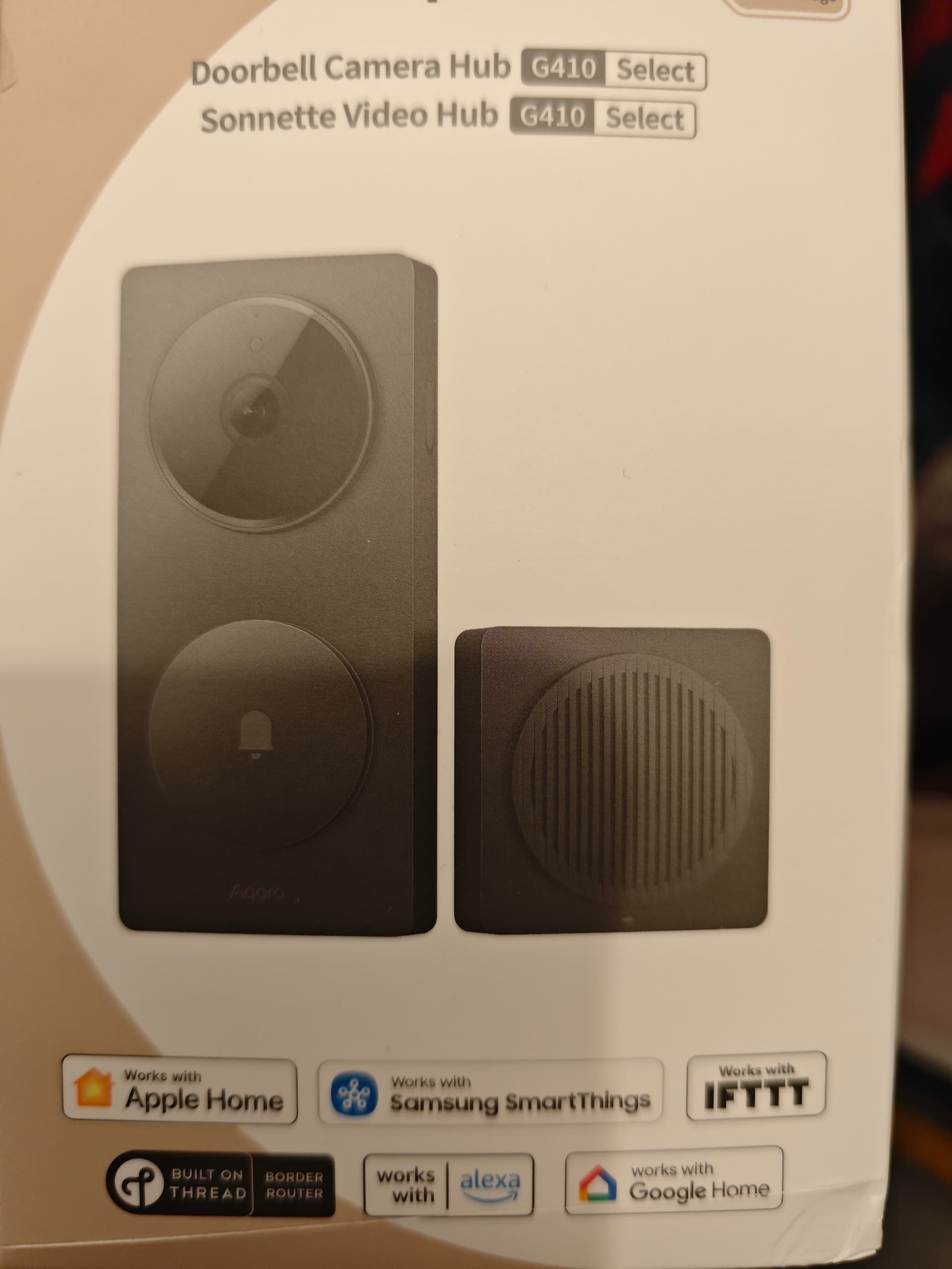

It appears that the G410 is actually an Aqara Hub device. Thus, I would think you could share it with Hubitat as a Matter Bridge. This should allow any devices paired with the G410 to be brought into Hubitat via Matter, assuming Hubitat has the proper drivers already. If not, you could look at @kkossev's Advanced Matter Bridge drivers to see if those would work.
Either way, further discussion regarding the Aqara G410 probably belongs in its own thread, separate from the Aqara FP2 discussion. Thanks!

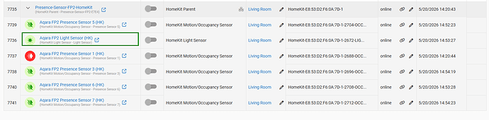

Well, my FP2s have arrived and bingo! They work great with HomeKit Controller. No apple device required at all. You guys are excellent, thanks for helping me with this. Brilliant :+1:

There is a workaround to export the FP2 occupancy states to HE via Matter using the Aqara-specific hubs 'Signals', but IMO the best method to bring the FP2 to HE is the inbuilt HomeKit Controller integration. I have been using it since the time it was added to HE.

When the FP2 is connected to the C8-pro, is the illumination sensor also enabled?
So can I automate the light on, when illumination is below 400 lux?
Yes
