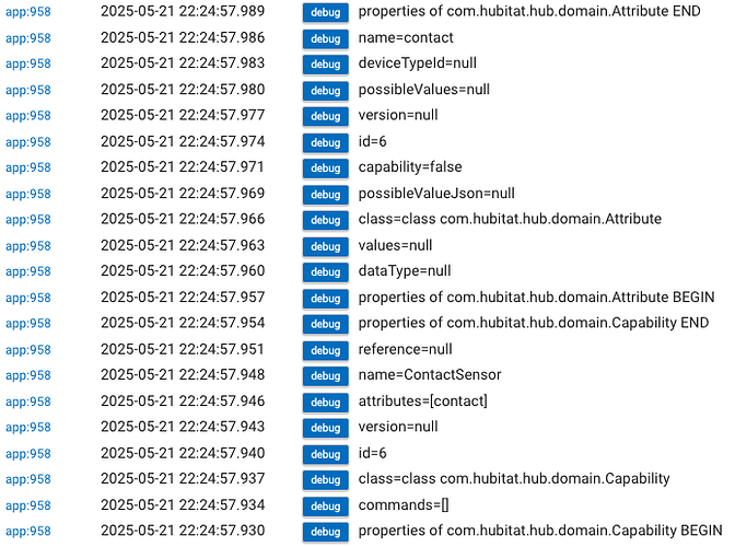

I get:
In particular, the possibleValues property of the Attribute object is null.
What am I doing wrong? Are these documented classes not accessible somehow?
