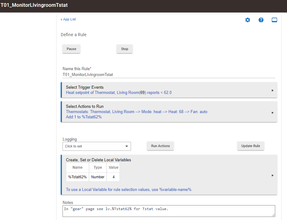

I've had this thermostat heat setting go low, enough so I wrote an RM rule to reset and count the issues. (Back with my C4 and many firmware versions ago) This rule has existed for over a year (see last screenshot). However this RM rule has not events recorded.

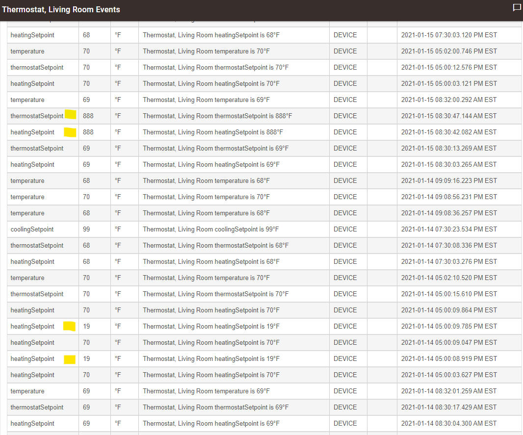

Recently I noticed the thermostat was set to 74°F. Never a setting we or scheduler will set. I believe this setting came about when the 888 °F entries were made but limited to 74 °F by a menu setting in the Tstat that limited the heat to 74 °F max.

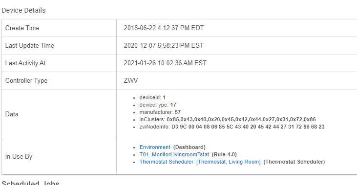

What driver is this using?

Built-in: Generic Thermostat.
