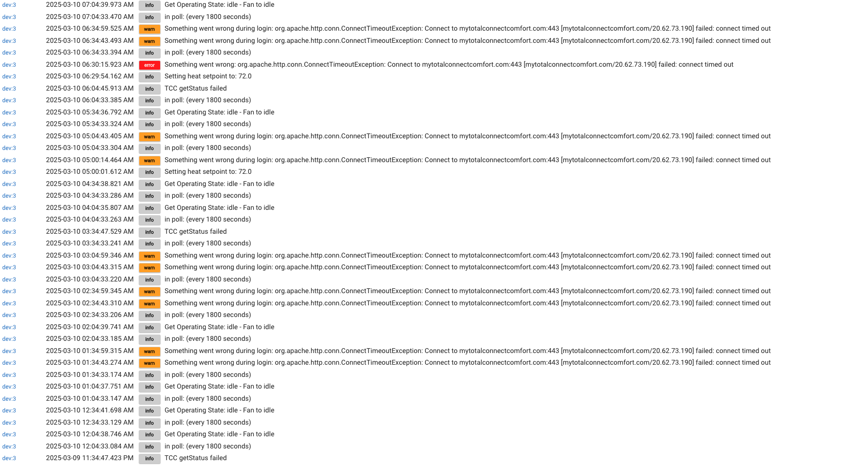

I'm using the UK version which uses a different app (not maintained by anyone) but have started seeing more connection errors from the Honeywell server. I have 5 minute poll times. Occasionally I'm getting made aware by Honeywell that it failed to set a zone when commanded by the app.

I've also seen similar, however I rarely seem to see login errors in the HomeBridge plugin I use (TCC is EvoHome in the UK). Using today as an example there have been more than a hundred connection errors in my Hubitat app but not a single one in Homebridge. I use Hubitat purely for automations (altering temps when we leave/return, cancelling overrides automatically, a pseudo window mode) whereas Homebridge is used for switching modes and altering temps from the phone. I wonder how the Homebridge plugin manages connection differently that doesn't cause timeouts.

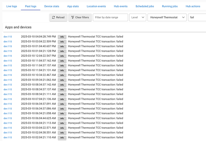

Below log snippet is filtered on "fail". The TCC Connect has always been fairly reliable, but prone to the TCC server.
