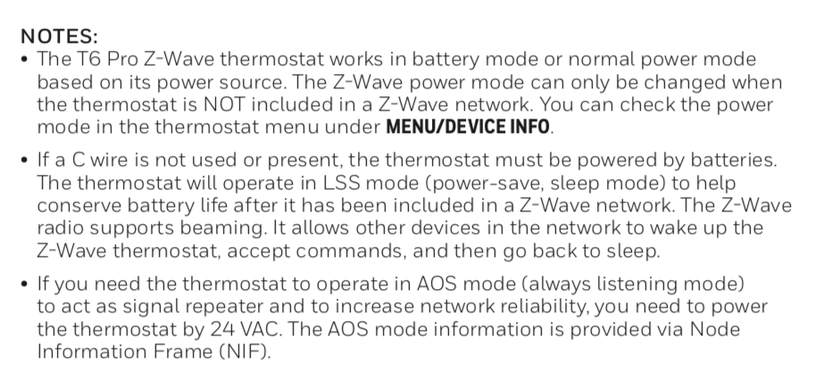

I did. It will not work as a repeater if paired while on battery power (even if its switched to a powered mode later on).
From the install manual:
