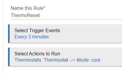

Solution: Created a rule to send the setThermostatMode to Cool every three minutes. This keeps the thermostat awake and ready to accept commands at all times. Never sleeps.
Issue: Behaves as though the Honeywell T6 goes to sleep every 3 mins and when the Alexa or Google issue the setPoint command it takes too long for the Honeywell to wake up and acknowledge the command. So Alexa says "Sorry, thermostat is not responding." Google just sends the command and does not wait to actually see if it was accepted.
I tried 5 mins and tested it. Five minutes is too long. Even after four minutes the thermostat does not accept the command. The count must be three. Three is the count.
