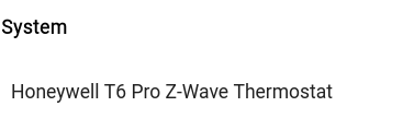

I was previously using this one (which is what it auto-chose when I paired the device):
After switching to the generic thermostat it seems to do correctly switch in and out of emergency heat.
