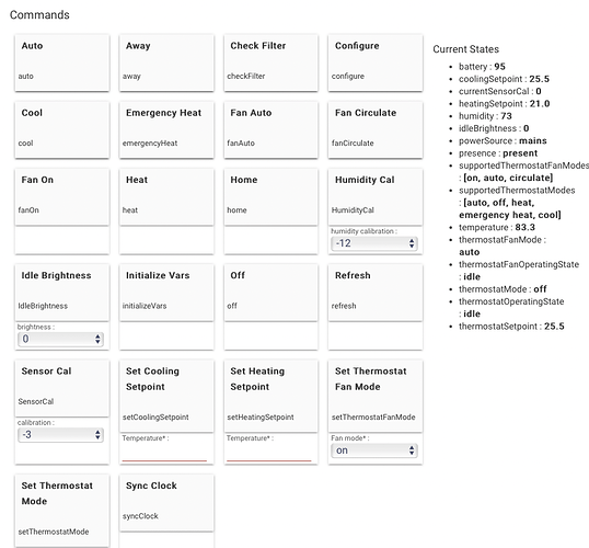

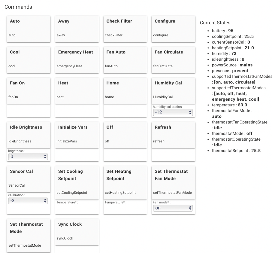

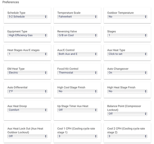

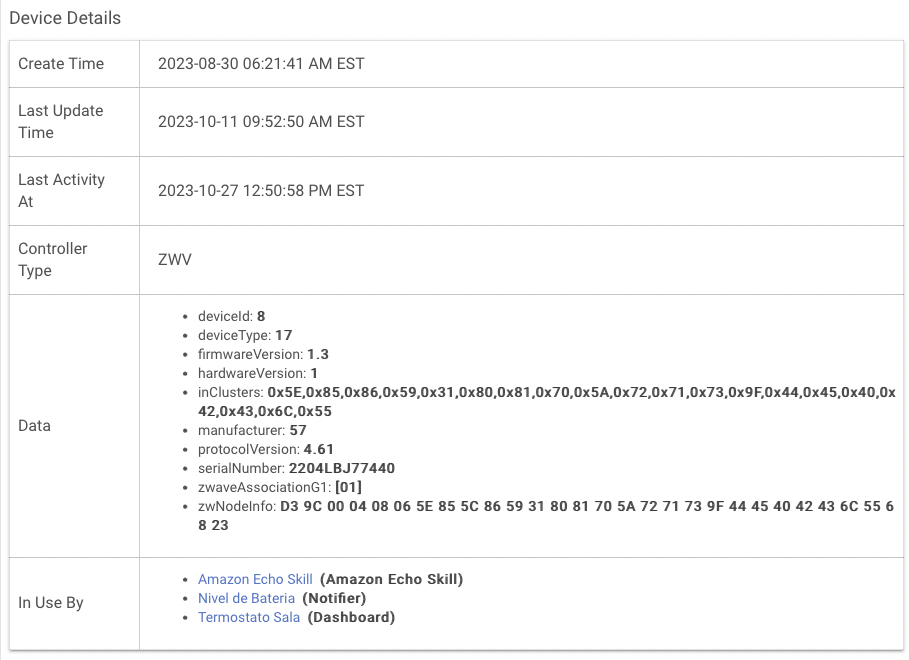

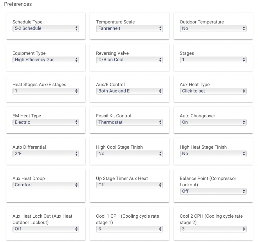

Can you post your z-wave details page in its entirety ? Use windows snip
Also post a copy of the device details page
Hi ,
Feel free to comment or if there is something missing. Thank you
Well it's definitely connected. Thermostat is off though. On your thermostat itself set ISU 300 to on. Then on the device page, put 75 under set cooling setpoint and click the button and see if you see the change directly on the thermostat

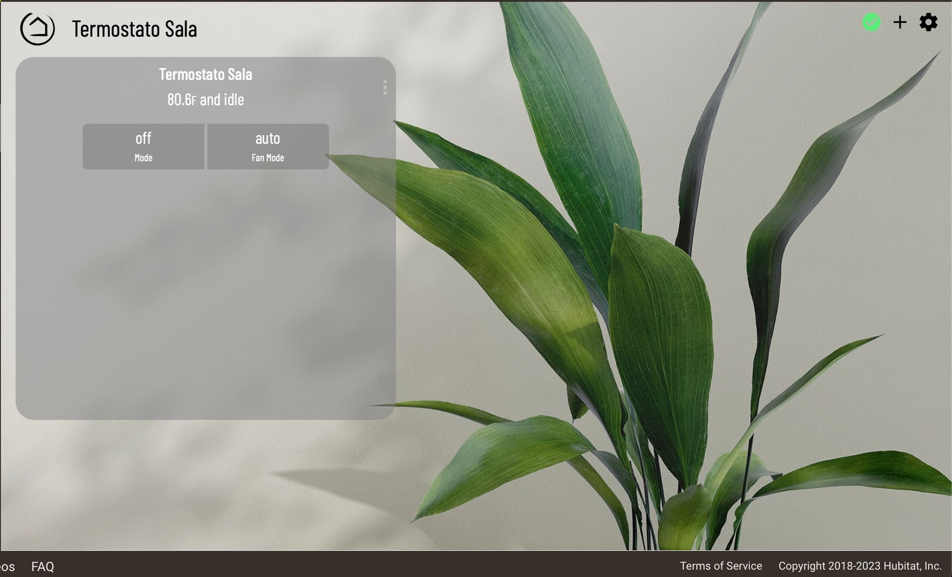

Hello. I finally had the chance to visit the project where I installed Honeywell TH6320WF2003. I made changes on ISU300 to ON and I am able to turn the thermostat OFF on the device menu, can not do anything from dashboard. What do you think is the problem? Thank you
delete the tile and re create it. (is it exposed to the dash?)
