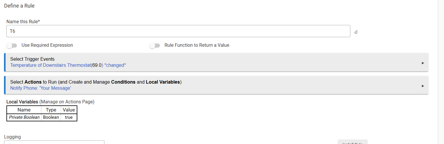

So hubitat will react instantly to any changes that your thermostat produces. What the external systems do is only controllable by those systems. So if your external app makes a change to the thermostat, you can have your external system change thje thermostat then have hubitat send a notification to your phone. From the change to the notification would only be a couple of seconds at most.
Something like this with rule machine.
Sorry, forgot the screen shot.
