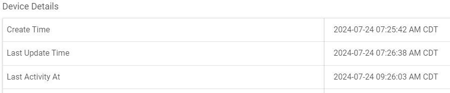

Ok, I just set it to 30 minutes interval. I will give it a bit and see if it resolves itself. When the sensors properly refresh/update, will the update and activity time be updated in the device record itself?
You will probably see the "Last Activity At" field get updated, but not the other fields. Those relate to when the device was created and updated (new code, perhaps). If you want to see more detail, go to the logs. If you want a lot more detail in the logs, turn up the logging to debug.
