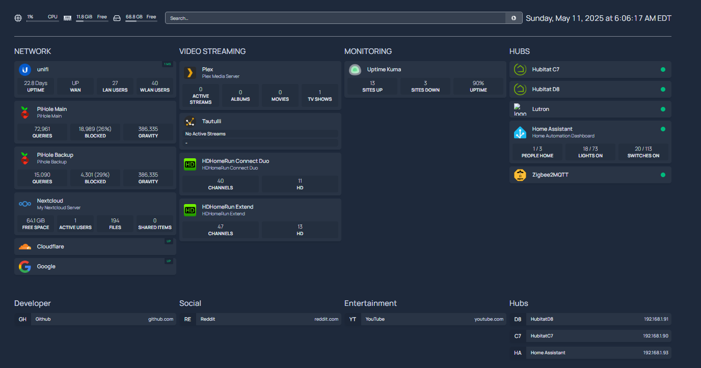

I haven't done much with it since May.
So far i was able to set up some integrations with Hubitat, but nothing too flashy:
It seems like quite a powerfull yet simple dashboarding app.

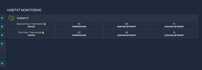

Can you share your snippet from the services.yaml. I'm able to get the values from MakerAPI using the Hub Info Driver, but not sure how to show it up on the hompage.
- HABITAT MONITORING:
  - Hubitat C7:
      icon: hubitat.png
      widgets:
        - type: customapi
          url: http://192.168.107.90/apps/api/521/devices/884?access_token=xxxxxxxx-xxxx-xxxx-xxxx-xxxxxxxx
          mappings:
            - field: label
              label: DEVICE
            - field: attributes[3].currentValue
              label: Temperature
            - field: attributes[8].currentValue
              label: Heating Setpoint
            - field: attributes[2].currentValue
              label: Cooling Setpoint
            - field: attributes[6].currentValue
              label: Mode
        - type: customapi
          url: http://192.168.107.90/apps/api/521/devices/883?access_token=xxxxxxxx-xxxx-xxxx-xxxx-xxxxxxxx
          mappings:
            - field: label
              label: DEVICE
              label: Temperature
              label: Mode
        - type: customapi
          url: http://192.168.107.90/apps/api/521/devices/1005?access_token=xxxxxxxx-xxxx-xxxx-xxxx-xxxxxxxx
          mappings:
            - field: label
              label: DEVICE
              label: STATUS
Results in this;

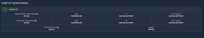

It gets wonky sometimes and the ["on","auto"] will show up on one of the 4 columns. I don't know why and haven't invested any time to fix it. I think it only allows 4 fields and I am trying to show 5.

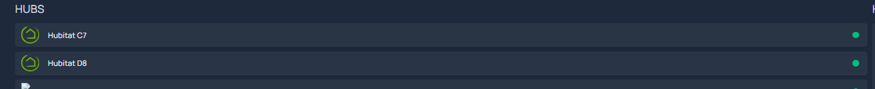

I have another section just checking if hubs are online:
  - Hubitat C7:
      icon: hubitat.png
      siteMonitor: http://192.168.107.90
      statusStyle: dot
  - Hubitat D8:
      icon: hubitat.png
      siteMonitor: http://192.168.107.91
      statusStyle: dot
That code generates this on homepage:

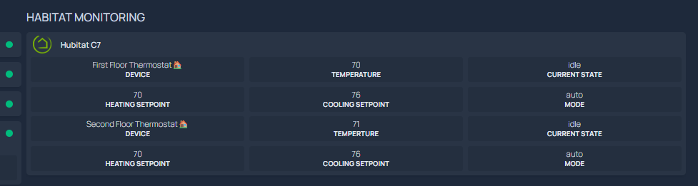

You inspired me to play with it and fix it. Now it is better.
  - Hubitat C7:
      icon: hubitat.png
      widgets:
        - type: customapi
          mappings:
            - field: label
              label: DEVICE
            - field: attributes[5].currentValue
              label: Temperature
            - field: attributes[1].currentValue
              label: Current State
        - type: customapi
          mappings:
            - field: attributes[7].currentValue
              label: Mode
        - type: customapi
          mappings:
           - field: label
             label: DEVICE
             label: Temperture
        - type: customapi
          url: http://192.168.107.90/apps/api/521/devices/884?access_token=xxxxxxxx-xxxx-xxxx-xxxx-xxxxxxxxx
          mappings:
              label: Mode
Now it looks like this:
