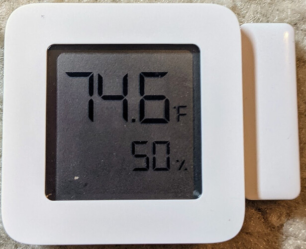

There is an update on LYWSD03MMC world. A new custom firmware add significant features to LYWSD03MMC.

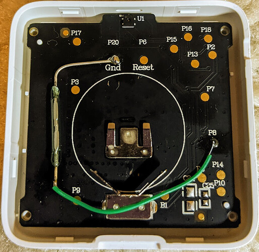

I am experimenting with the reed switch feature. I tear mine apart and soldered a cheap reed switch.
I put it back all back after the soldering.

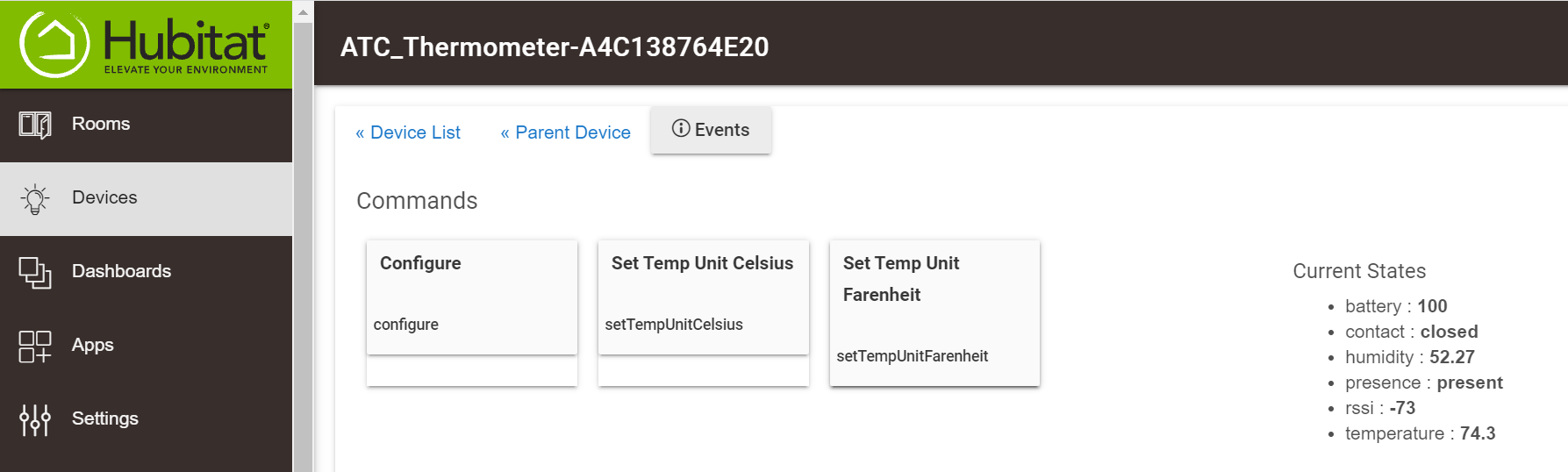

Here is how it looked like in hubitat using the my Bluetooth gateway.
Warning: The reed switch status is broadcasted. I would not use it to monitor something critical. Everyone with Bluetooth sniffer within the radio range will be able to see the same status.
