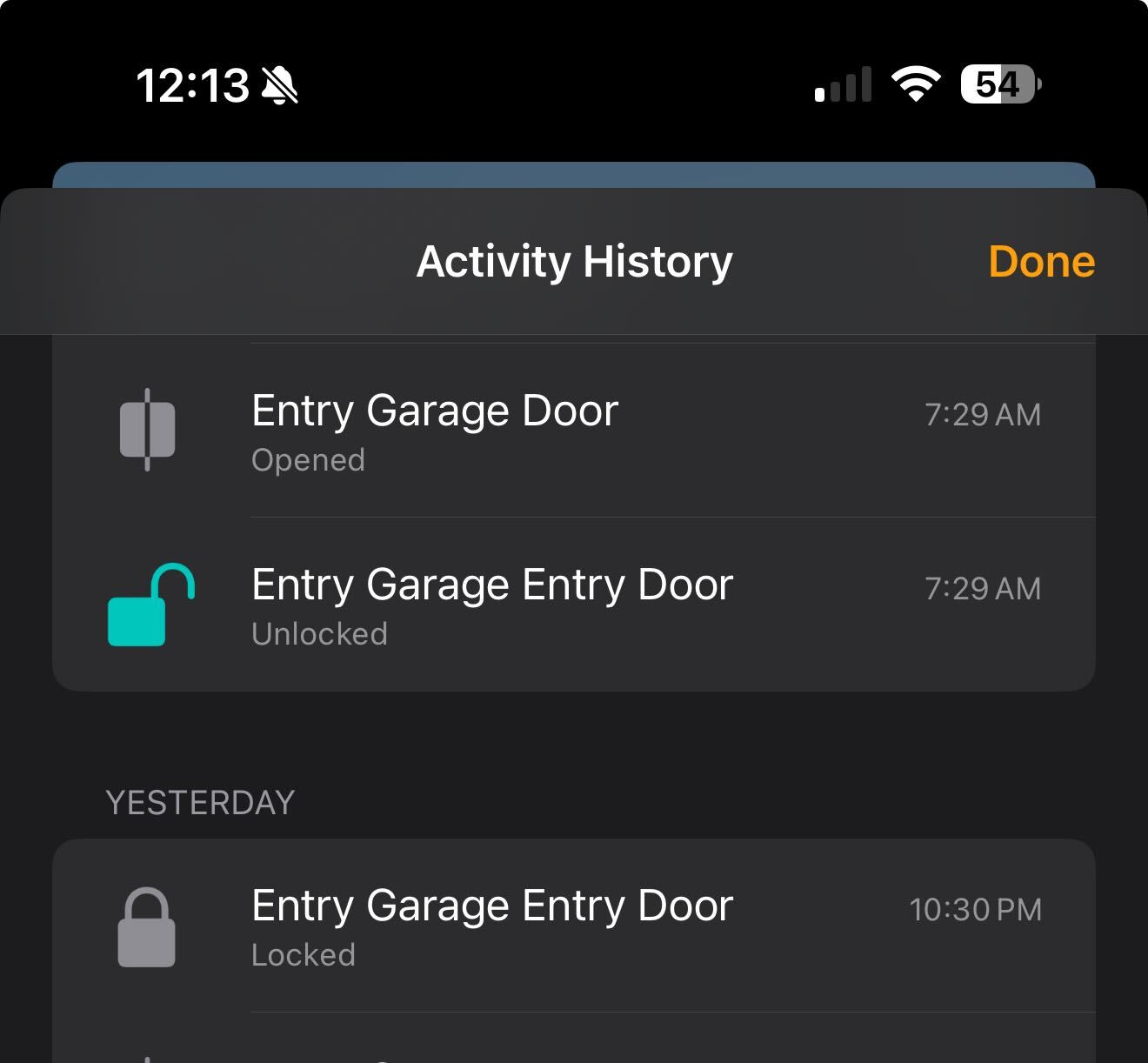

I currently have the kwikset 620 and 914 Zwave deadbolts on my network. These locks work great and have been super reliable. A problem that I am running into is Homekit will not push the notification the door has been locked or unlocked (Manually/with a code). If I restart Hubitat i will usually get a couple notifications. If I have the Homekit app the Manual lock/unlock change shows in the app immediately. I have read in a couple places that this could be due to the Homekit code in Hubitat not sending the command for a notification. I would also like to note that I have a Z-wave relay for my garage door and it very reliably pushes the notification to homekit every time. I have this Door lock setup in two different locations on two separate hubitats and I am experiencing the same issue. Does anyone else have this issue and know of a fix?

The events show up in Hubitat, The past events even show up in the Homekit history but no push notification. Notifications are on in homekit and come through every once and a while. Using and Apple tv that is ethernet hardwired.
Everything is working except the push notifications.
