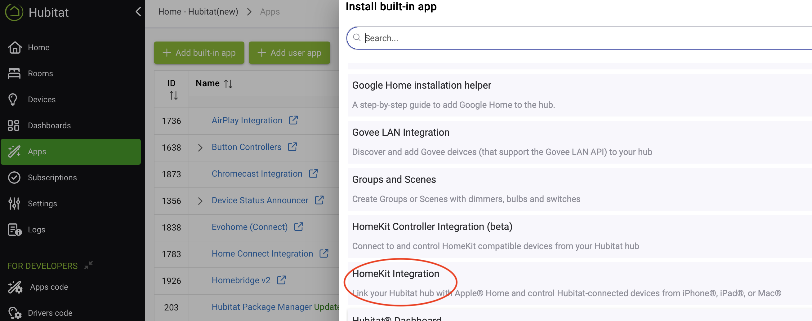

Have you installed the Homekit Integration first on your Hubitat as shown in the screenshot below?:
I do believe that's the origin of the QR code he's referring to.
I’m at work at the moment. But that’s correct. When I open the HomeKit integration it gives me a QR code and a setup number.
