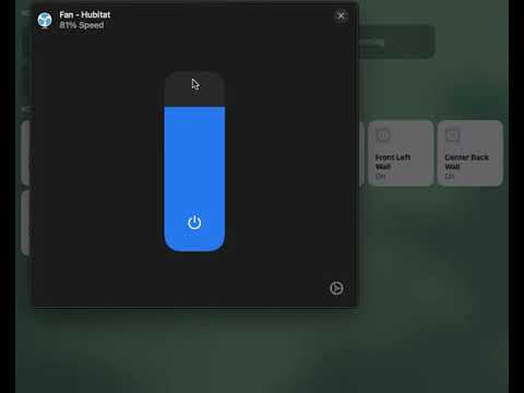

When I add a Leviton ZW4SF Fan Controller to Homekit, the accessory shows up fine, but the speed control doesn’t work. It immediately snaps back to zero despite the fact the fan is running.
This accessory works fine with Tonesto7’s Homebridge plugin, and it works fine from inside the Hubitat UI, so this seems to be an issue with the way fan accessory handling in the Hubitat Homekit app works.
So far other ZWave accessories seem to be working well.

I don't think it's the Home app - I have not seen this with Homebridge. I have 2 instances of the fan right next to each other in the home app, and Tonesto7's accessory works perfectly while the Hubitat accessory shows the speed at zero at all times - and as I said, the device controls in Hubitat work fine as well.
I don't see any HomeKit errors in the logs.

Oh there is no doubt that sometimes things get weird. Yours looks like dropped packets with a plugin or accessory that doesn't automatically retry. In this case I have the same accessory in the Home app twice through 2 different bridges, and they both immediately reflect on/off correctly from each other and from the fan speed controller itself - but only one of them correctly updates the speed setting.

That the Homebridge fan. The beta Homekit app is not working for me either way and it just snaps back to 0% every time.
This is definitely a problem with the Hubitat beta app. The actual fan driver will force the speed to the closest valid value. The Tonesto7 plugin reads the updated value from the driver after trying to set it to the slider value, then the slider pops to the correct location. No matter what, even when set physically the Hubitat Homekit slider stays at zero.
